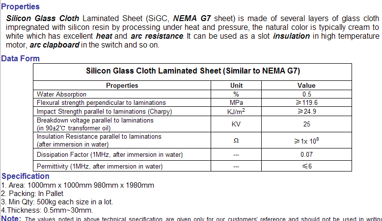

Silicon Glass Cloth Laminated Sheet (Similar to NEMA G7)) I2 y/ I" ?/ f9 v, _
; u8 E/ x/ L. |2 bProperties Unit Value
5 j& t, m! J% K" v; RWater Absorption % 0.5
+ p& _) {; r9 q8 @; ]. a/ [2 g, bFlexural strength perpendicular to laminations  MPa ≥119.6 3 R& U8 ]% ?- I1 q6 t# k
Impact Strength parallel to laminations (Charpy) KJ/m2 ≥24.9
, ^' z7 V2 G3 r! Y  rBreakdown voltage parallel to laminations # [$ g4 r. ]$ t9 Q  h
(in 90±2℃ transformer oil) KV 25 " ~" R& K; [* I5 e: @  t3 t
Insulation Resistance parallel to laminations ; ]. E+ b8 z8 c9 q4 v
(after immersion in water) Ω ≥1x 108 % M$ `+ a8 a* j% e4 }5 i; c
Dissipation Factor (1MHz, after immersion in water)  --- 0.07
; O0 j9 [1 r& G, t, d' V. \" cPermittivity (1MHz, after immersion in water) --- ≤6 0 M& D" ^# W& t% G( w8 R
5 e& J. I$ P" m$ L5 C% C* q8 x3 }
Specification 3 v6 F! D, [6 G) }; o6 l0 w
1. Area: 1000mm x 1000mm 980mm x 1980mm
( W4 B! A3 q' y" {5 M/ c2. Packing: In Pallet 8 R) w! }- P4 y
3. Min Qty: 500kg each size in a lot.
1 h( e2 V9 W6 |" i( S4.Thickness: 0.5mm~30mm.
发表于 2009-6-25 17:32:37 | 显示全部楼层 来自: 中国四川成都

Silicon Glass Cloth Laminate Sheet (NEMA G7)
/ f" r' S8 @$ T# R. `1 d; X应该就是2楼说的这个,http://www.dexlu.net/dexlu/rl/G7.html
