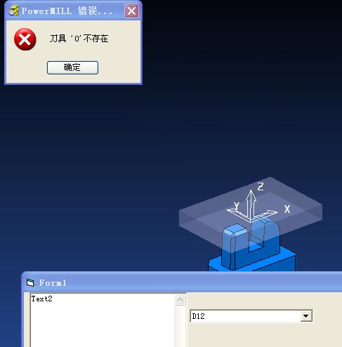

高手首先谢谢你啊!( a- W: z+ o& X) l, J  A7 C
现在我要激活刀    可是选不到刀6 c. L, q, ?+ j# A! t* N# Q
是不是不能这样写??PowerMILL31.Execute "ACTIVATE TOOL " & Val(Combo1.Text)
4 Y8 F; S1 h6 W报警说“0”刀不存在!!!                        特别急啊 # W% k! C+ @, C4 ]: B4 E) q& ~, E
Combo1.Text要换成什么代码PM才可得到列表里的“刀具”啊??

发出你写的获取刀具路径的那段代码来

发表于 2009-10-8 10:40:55 | 显示全部楼层 来自: 中国浙江杭州
我也想知道!
- Q- u- ^. l/ ?9 C- y
) P8 s; \$ f/ m) T. y. _/ rPrivate Sub Command3_Click()
8 @# }# z! j5 H& H% m) E' S% \PowerMILL31.Connect
# r# o2 k+ D1 [1 G' P. A" ZPowerMILL31.Execute "ACTIVATE TOOL " & Val(Combo1.Text)
) m# j% c1 D7 Z) oEnd Sub
9 e" l' U0 I: {6 H& Q/ X8 t2 U  Z- `, O0 |7 `9 S: Q
Private Sub Form_Load()
# K9 {+ A# e) j0 g- D0 G$ L) j4 v0 t/ k# ~) {
PowerMILL31.Connect& A8 I/ u( ~. u* }/ N/ L! T
  Dim result As String                           '变量定义6 {8 |; h$ u, b) S
  Dim SplitResult() As String              '数组定义" E9 K% @: V" d
7 n- Z# d" H( b& |( i% |
      Combo1.Clear
  n$ x" D+ o) U4 U$ H! V' p
! }3 o+ @  s& T1 ^& `, X$ t
1 Y5 a2 u; I9 L9 \6 _9 b% [& \PowerMILL31.Execute ("DIALOGS MESSAGE OFF")) o$ U, w0 L5 A  ~0 V" x  k. P. `
PowerMILL31.Execute ("DIALOGS ERROR OFF")
; x/ x5 p0 g$ }: v# F& u3 o, u9 V, W( L5 ]: E8 f7 ]- f# ]) B
result = PowerMILL31.ExecuteEx("Print ENTITY TOOL")
  M: }4 G  \  a, f) n$ o2 m" N
: Q+ b) t1 Z* ]5 r0 r0 o
* g, x4 ]' k5 r- P& K" kSplitResult = Split(result, " '")
" u. i4 k+ b6 V+ d8 }4 x/ ]0 jFor i = 1 To UBound(SplitResult)
5 \& H5 f0 t6 v0 ?    SplitResult(i) = Replace(SplitResult(i), " ", "")$ s, {/ k% C( P
    SplitResult(i) = Replace(SplitResult(i), "'", "")
) n. Q4 P8 H2 O# A" X2 }/ s    SplitResult(i) = Trim(SplitResult(i))( T5 w1 b1 H- e* x6 f- Z
    If SplitResult(i) <> "" Then Combo1.AddItem SplitResult(i): a  V/ ^% Y1 \! e7 z$ B2 H8 m
Next i) b% Q+ e& \2 t0 C8 C  X( e) k0 s
9 Q5 U: I" A" l+ E$ z( D6 n7 APowerMILL31.Execute ("DIALOGS MESSAGE ON")
/ s0 G  {& b% i4 L+ |* QPowerMILL31.Execute ("DIALOGS ERROR ON")
6 \& U' _: z: I" g; \, K0 w, S0 O. G, Q3 d/ j, c
End Sub
 楼主| 发表于 2009-10-8 19:07:34 | 显示全部楼层 来自: 中国广东东莞
哈哈 ;搞好了  谢谢大家 犯了低急错误 PowerMILL31.Execute "ACTIVATE TOOL " & Val(Combo1.Text)    改成             PowerMILL31.Execute "ACTIVATE TOOL " & ValCombo1.Text就OK
