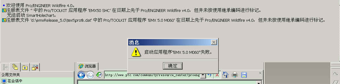

PROE4 M080挂EMX5 M060出错,请帮忙  H2 }! K- t9 |7 H. I
SNAG-0001.jpg * G  O  s7 m! \* f* x/ P

确保以下语句正确。
name EMX 5.0 M060
. q3 m0 {& D! B8 I$ Tstartup dll
5 ^5 @: e4 \# ~exec_file D:\emxRelease_5.0\i486_nt/emx50_wf4.dll
3 C7 t* e( ]0 V2 `text_dir D:\emxRelease_5.0\text+ a- h  z3 r+ Y9 k. i3 U  u
revision 25.0/ S3 ?% Q( M, N# u( R7 `  r
allow_stop FALSE* n# _" O+ \& G& z( _' H
end: d" R: U# B5 }+ s
6 X: ]% }6 y1 o- q* I
' V& h: q* |6 P3 _) U* r- S4 X
启动目录CONFIG 写入以下语句:) N  @1 d! F- r1 q
protkdat d:\emxRelease_5.0/text/protk.dat

问题解决了  O2 v4 W; k1 N6 I
主要是这句的问题      exec_file D:\emxRelease_5.0\i486_nt/emx50_wf4.dll
8 r; c, r2 r( @
/ x9 y. c; G% E3 H- _刚安装完后这句是      exec_file D:\emxRelease_5.0\i486_nt/emx50.dll' T& `" R* A( K* @! U
8 A& R2 e5 E, h1 V1 |" w( ~需要修改,把 emx50.dll  改为 emx50_wf4.dll
