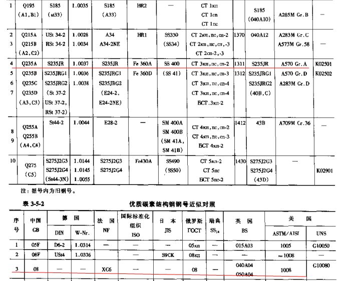

ASTM:美标# M  J2 L- H- c5 @$ b8 R
ASTM A569/A569M-1991 普通级碳素钢(C≤0.15%)热轧薄板和钢带 ,和国家标准Q215机械性能、化学成分类似,
