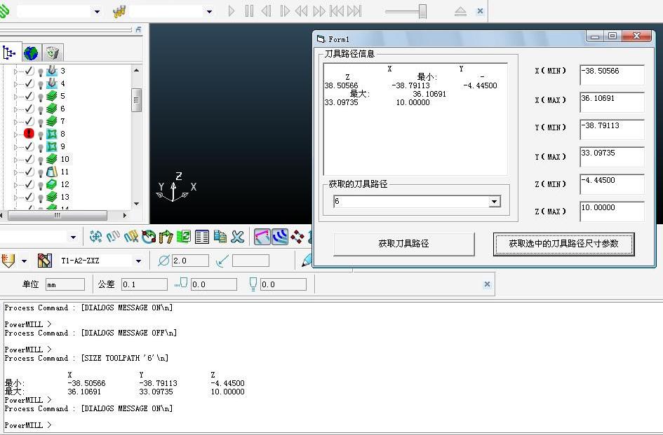

各位老大!小弟有一事相求,在vB用什么命令可以获取刀路属性里的x,y,z的正负值啊,为方便理解现附图一张,期待热心人

发表于 2009-12-17 12:59:33 | 显示全部楼层 来自: 中国浙江杭州
回复 2# t253377892 的帖子
VB6.0代码!参考一下!
6 ?9 p. {9 \, |( Q1 }1 h
# E+ y5 o, f( X3 p5 J5 TDim parameter As String
5 x& F) T0 q! w5 ?: H1 Ppm_start (0)" Q, p8 ]# S( {4 d/ K
pm_send ("EXPLORER SELECT Toolpath 'Toolpath\5' NEW")
# X% t5 B7 {( C7 X5 a. AText2.Text = pm_send_ex("SIZE TOOLPATH '5'")
: w" A' ~4 f, i# ?% W* A3 _pm_disconnect
0 k6 w) J( c! ~4 Y; h( m5 x; e% x, G+ Q. h

发表于 2009-12-17 17:15:17 | 显示全部楼层 来自: 中国浙江杭州
Private Sub Command1_Click()6 W, I! ]/ |6 K  K2 x% K; N, \1 b
Dim S As String, K() As String, Q) ~: z* K, ^) M  ]+ O/ K2 V
pm_start 0* I$ x  d- W, L' T* Z
S = pm_send_ex("SIZE TOOLPATH '5'")+ N3 T# u$ W/ _, Z3 F, a2 a3 ?
pm_disconnect8 A7 m, n" _' }
Text1.Text = S2 x: M% [. c1 ?0 Z* o, p9 I
Do While InStr(S, "  ")7 `6 V3 X5 W$ j6 a& d7 M! t! R
   S = Replace(S, "  ", " ")$ s6 G  ]4 Y4 ~+ @
Loop
9 l# d. a5 j4 o8 e; IS = Trim(S)# ]3 E" {% A8 t9 L3 _* _# T
K = Split(S, " "): U8 M0 h9 a8 m; i6 i0 m
Text2.Text = K(4)9 |" O" j( Q/ _6 ]6 t
Text3.Text = K(8), h; t+ t6 h3 r8 u  J5 \# |
Text4.Text = K(5)1 f! ^9 v) K0 j& ^8 U1 _4 z( `( y
Text5.Text = K(9), F: U+ C* o% D  Y/ j  I7 O
Text6.Text = K(6)1 b1 Y* h% r9 h; N
Text7.Text = K(10)
& `% l% I3 u2 A) z7 s! I' OEnd Sub
3 D1 ]2 o7 G, \" D3 C. i* C2 Z; |  `再试一试这段代码!

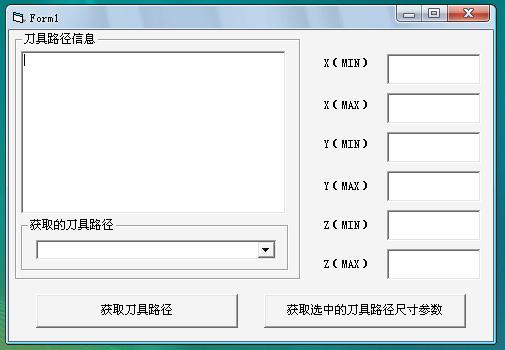

发表于 2009-12-17 17:42:46 | 显示全部楼层 来自: 中国浙江杭州
/ @$ z$ f* T; ?3 Q; h9 \. g' IIf Combo1.Text <> "" Then
& n4 d; Q8 i# oDim S, aaa As String, K() As String
* z$ F# f# `0 @0 v' Daaa = Combo1.Text( O" W  u7 X' {5 l8 y
pm_start 0
  W7 a+ A9 W( H$ C! o5 M, I7 _$ fpm_send "DIALOGS MESSAGE OFF"& Q' @, a( E$ Q4 T: N7 w; b
S = pm_send_ex("SIZE TOOLPATH " & "'" & aaa & "'")
5 j& ]. h0 X6 f# Q" Y0 ^pm_send "DIALOGS MESSAGE ON"+ C! g# b8 u6 K) M- a
pm_disconnect
6 I- ^9 T3 b) |# t; v6 ^9 `7 _Text1.Text = S. i: @7 H+ r6 l- x
Do While InStr(S, "  ")) ^1 R8 o1 k/ r; ~& @( Z& E
- X2 b  I$ M  i# nLoop+ C1 v! [7 z+ M6 ^8 u( |% Z
S = Trim(S), E& R( U+ l' l2 ]
K = Split(S, " ")' z# o; k, L4 D1 B
Text2.Text = K(4)% {; s% X, D: e; ?' Z. y7 P
Text3.Text = K(8)4 l6 B8 c( [9 O- ~/ e4 z2 P
Text4.Text = K(5)& M, \% ~- i( O$ e; G5 U
Text5.Text = K(9)2 ?) e) n' v( c& ^
Text6.Text = K(6)
( E4 i* E6 ~2 C" d6 iText7.Text = K(10)
# @6 ~# N6 a7 [/ c) x1 u5 XElse
, b  h( R- a2 V$ ^/ V5 dDim Response
, b- e  y. \3 a; a9 G4 R7 M   Response = MsgBox("请先点击获取刀具路径按钮!", 48 + vbOKCancel, "提示!"); g7 R/ L" f' k/ z/ m
   Select Case Response- v7 o# i8 B8 w' y; M, y
      Case vbCancel
" n4 D! Q+ J! o2 U+ ^0 C         Cancel = -1) u9 c6 B8 }/ l6 D' U7 |, k1 D
   End Select
, T+ {8 _# r+ uEnd If
5 N3 d/ ]5 c  z% @# p7 MEnd Sub
2 }& T/ [4 |- U2 w0 C
* Y1 _' R- h3 H& Q; A' `" X8 NPrivate Sub Command2_Click()
/ k9 p2 R) ^, r0 Y( R( ]- \8 VCombo1.Clear$ W9 a( Y6 \6 a" y, G2 N
If Combo1.List(0) = "" Then
# D/ ]6 `( n  [, aDim m, mm As String
( O* b9 @, G8 R7 W+ M% j' N- {/ ppm_start (0)
9 ~5 [- k( e0 y* Z- G. T' [m = pm_send_ex("print entity Toolpath")5 L& D0 K* Z) }+ H1 o
pm_disconnect
) |* p7 t' G: QDim a As String, i As Long, j As Long
6 A. O4 Z* f; W, E+ Ma = m
' N1 m  a* l# nj = 04 w% M2 p- \- P8 L0 l
Do3 V2 f5 q" |4 j& a% a0 j
i = InStr(j + 1, a, "'")( `9 C7 w5 G0 p0 j8 P. f/ w
If i > 0 Then: z* ^( z. z# ?: A( N) X9 A8 y
j = InStr(i + 1, a, "'")
# A4 a4 }! Q5 n1 OIf j > 0 Then: q' z* \5 k0 O- G
Combo1.AddItem Mid(a, i + 1, j - i - 1)
4 u% |  V8 J6 d2 ?, \& i6 NElse
; s) N6 d" R; _Exit Do$ x7 }/ n( P9 a
End If5 f* i* Y  X* p( T1 ?) l9 D1 t
Else7 L$ A1 l$ h; R1 z5 j9 ^
Exit Do) f( J7 F! d" @# e/ A
End If; U2 L+ V, h& q5 M% v$ N
Loop8 L& f' ^: S3 ]. L& N" o
Combo1.Text = Combo1.List(0)! ?8 {. K5 W1 N: p
End If
4 E. H# M5 V+ O  g9 G& mIf Combo1.Text = "" Then
+ j. O7 L) u1 NMsgBox "没有刀具路径可获取!", vbDefaultButton1, "提示!"% p  U9 U2 K* j& B9 O* x
End If6 k( E8 t( x+ Y1 V5 H8 B6 l
End Sub
2 t# [0 Z; ?5 u+ ~! K9 N8 e( [# J5 w2 j. n$ b
7 K3 m1 G9 S- j, w( t/ }, W$ G
这个肯定可以!我已经试验过了!
