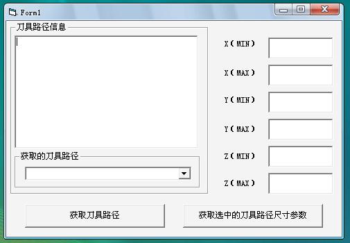

用VB获取刀具路径尺寸的外挂!(含源代码!希望对大家有用!)  l9 S3 h/ h# B: o
) h0 m: O7 R* z+ A' h
# q5 K5 o9 w% S1 m0 u6 ~8 e- ?1 ^% Q& _0 d$ r
) l( A" I* K( m) }1 l, E! S   |: v# K1 Y( V0 D- S
下面是源代码:3 p* ^1 ^7 Z. u- s0 j7 y) ?: V
: P) w7 Z9 t/ l0 E$ V
8 l$ l! m6 ~$ \0 [( nPrivate Sub Command1_Click()
0 M7 E! S* I4 P9 y: |6 lIf Combo1.Text <> "" Then
8 O% c- Z% E' Q: TDim S, aaa As String, K() As String% Q, Y/ N' p! d- t; s
aaa = Combo1.Text# q6 I3 r3 t/ \# g
pm_start 0
/ v7 {4 u& N. npm_send "DIALOGS MESSAGE OFF"
: C$ J& K7 i8 J% j" Z! P+ BS = pm_send_ex("SIZE TOOLPATH " & "'" & aaa & "'")
8 j( r8 h2 Z2 H0 q) Ipm_send "DIALOGS MESSAGE ON"
$ S3 y/ k6 V/ W' t9 R: s* ^pm_disconnect, `5 U, }) ]+ g8 ~
Text1.Text = S
9 R0 W: K8 c4 bDo While InStr(S, "  ")
  b) f# B# P( C+ I2 }   S = Replace(S, "  ", " ")
( C0 u9 |2 h; _( bLoop
2 U# P4 v' a2 C  I2 e5 OS = Trim(S)
/ [2 k. C" i8 s# L2 \% }K = Split(S, " ")5 q. [$ z% Z$ z
Text2.Text = K(4)8 p( B4 B6 n7 J$ {4 Y1 N
Text3.Text = K(8)
$ o; z) J! F, M: H, f) [1 ?3 V" HText4.Text = K(5)' ?! s, D4 {1 W; R8 ~: F& w$ t
Text5.Text = K(9)# G  ]$ G& t& S2 G9 z0 M
Text6.Text = K(6)
* H: ^: y7 n$ C: N( b3 N- P+ [Text7.Text = K(10)
; J# e4 ^- s0 \7 {* |Else
6 C* F3 z! u6 D: g, a- ZDim Response( F" G: j$ g& i6 N- k, c4 V
   Response = MsgBox("请先点击获取刀具路径按钮!", 48 + vbOKCancel, "提示!")
$ `# i* c4 |9 `3 B2 b) N   Select Case Response  u% N" i4 l4 x8 U
      Case vbCancel
% B; p. E  {/ D         Cancel = -1
0 ~' p( o4 H- G  b   End Select  ]/ ?7 N# [, i3 o8 }/ t* E
End If. N6 F2 G7 `0 |9 C1 x; B" N* g& F! q
End Sub

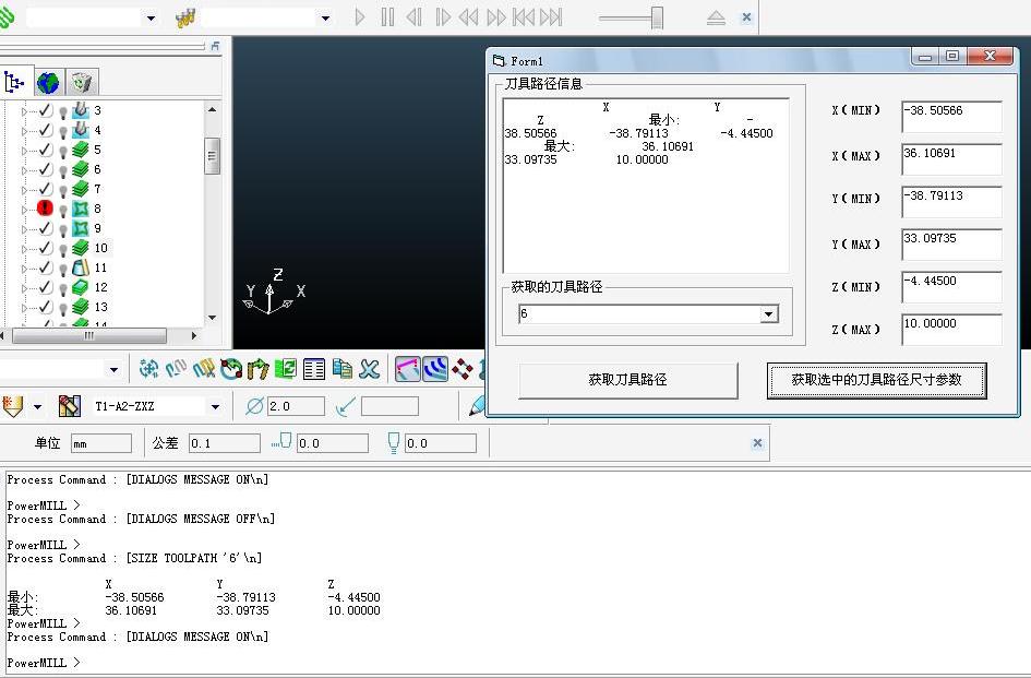

Private Sub Command2_Click()
0 _8 Q, j. P- j- b, HCombo1.Clear
8 F5 b, Q( ?+ u- \If Combo1.List(0) = "" Then4 h0 ?, u  P! ?) A1 p
Dim m, mm As String* z+ O( t% d7 N; G6 |
pm_start (0)
+ Y$ m* S* j1 F: D5 zm = pm_send_ex("print entity Toolpath")$ {2 k0 C; w9 n' E# P& @
pm_disconnect, X, s% u* V$ [( Y; L& ?& I$ j$ F
Dim a As String, i As Long, j As Long5 E9 W- q) B: o: `' L* B% U. j
a = m
& q+ ^7 E2 c' H3 Jj = 0
7 p0 {8 R: L/ Q& \" pDo
4 p6 H0 b5 [0 }4 u7 {5 ci = InStr(j + 1, a, "'"): _* z0 H3 M: U; Q- N) V% b
If i > 0 Then) F* o! ~/ r' l" ?. x; y+ ^: k
j = InStr(i + 1, a, "'")/ r1 v4 v+ |2 n) a& W+ p
If j > 0 Then' Z9 S0 t. J1 C6 ^  T9 t" F7 ?
Combo1.AddItem Mid(a, i + 1, j - i - 1)
/ r% z# T9 Z" |8 i1 R6 |/ VElse
" c; w4 b, Q. ]9 }  o3 {Exit Do
* A* L' r- A0 V8 }End If
, n' u" A6 C) f# V: r2 ]  ~Else
( s& O( z7 a+ ^# vExit Do2 k8 `& ^* j" p' l4 `
End If$ e. z& t1 w: X+ W
Loop- ~8 ]% p, Z" E
Combo1.Text = Combo1.List(0); ]# N8 W3 M. A, ?3 t* j  B( D
End If
( Z0 Z8 ^) Z- V  p: Z- V% |If Combo1.Text = "" Then" E: O* j$ R! r$ _
MsgBox "没有刀具路径可获取!", vbDefaultButton1, "提示!"
# Q0 u; @  p/ p, PEnd If
: ?6 @9 K" T9 X& |  e0 tEnd Sub
