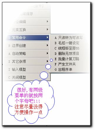

在右键菜单命令名称前加一个键盘符,当弹出右键菜单时,按下相应的键盘符即可执行该命令!( G2 A  A: Q# w0 p  b
体人使用后大大提高了编程速度,希望对大家有一点帮助。

 楼主| 发表于 2005-11-30 01:46:00 | 显示全部楼层 来自: 中国广东中山
还不够详细吗,就给你看看俺的快捷键吧!I "T 修剪" 1 "QUIT FORM TPLIMIT EDIT TOOLPATH LIMIT POLYGON EDIT TOOLPATH LIMIT DELETE Y"I "C 移动复制" 1 "macro 'C:/PMILLHOTKEY/HOTKEY/FUNCTION/移动复制.mac'"I "R 删除已选" 1 "DELETE TOOLPATH ;  SELECTED"I "M 移动下刀点" 1 "ROTATE TRANSFORM TOP QUIT LIMIT CANCEL MEASURER CANCEL EDIT TOOLPATH MOVE_START_POINTS"I "S 复制刀路"  1  "COPY TOOLPATH ;I "U 删除刀路"  1  "DELETE TOOLPATH ;I "6 自动+0.1" 1 "macro 'D:/JIN/自动+0.1.mac'"I "7  1392" 1 "EDIT FRATE 1392 EDIT RPM 15000 RESET TOOLPATH FEEDRATE"S I "建参考线" 1 "macro 'C:/PMILLHOTKEY/HOTKEY/BOUNDARY/建参考线.mac'"S                                           I "Q 批处理"  1  "MACRO 'C:/PMILLHOTKEY/HOTKEY/PROCESSWAY/批处理.mac'"I "W 过切验证"  1  "MACRO 'C:/PMILLHOTKEY/HOTKEY/PROCESSWAY/过切验证.mac'"I "L 精加工菜单"  1  "FORM FINISHINGI "X 测量"  1  "QUIT MEASURE MODELI "I  关闭精加工菜单"  1  "FINISHING CANCEL"I "P 粗加工菜单"  1  "FORM AREACLEARMODELSI "2 等高水平圆弧90度"  1  "MACRO 'C:/PMILLHOTKEY/HOTKEY/PROCESSWAY/水平圆弧90度.mac'"I "F 抽" 1 "MACRO 'C:/PMILLHOTKEY/HOTKEY/PROCESSWAY/抽.mac'"I "5 自动扫平面" 1 "macro 'C:/PMILLHOTKEY/HOTKEY/PROCESSWAY/5扫.mac'"I "E 扫平面" 1 "MACRO 'C:/PMILLHOTKEY/HOTKEY/PROCESSWAY/扫.mac'"I "Z 清角自动" 1 "MACRO 'C:/PMILLHOTKEY/HOTKEY/PROCESSWAY/清角自动.mac'"I "J 单刀清角" 1 "MACRO 'C:/PMILLHOTKEY/HOTKEY/PROCESSWAY/单刀清角.mac'"I "O 挖孔" 1 "macro 'C:/PMILLHOTKEY/HOTKEY/PROCESSWAY/挖孔.mac'"I "V 锣料头"  1  "MACRO 'C:/PMILLHOTKEY/HOTKEY/PROCESSWAY/llt.mac'"I "8 石墨平行扫面" 1 "macro 'D:/JIN/石墨平行扫面.mac'"SI "1 草绘边界"  1  "MACRO 'C:/PMILLHOTKEY/HOTKEY/PROCESSWAY/草绘.mac'"  I "D 2D边界补正" 1 "EDIT BOUNDARY ; OFFSETI "Y 2D补正" 1 "EDIT BOUNDARY ; OFFSET 1 EDIT BOUNDARY ; OFFSET -1 ROTATE TRANSFORM TOP FORM EDITOR EDIT BOUNDARY EDITORI "` 直线直刀" 1 "EDIT TOOLPATH LEADS LINK STRAIGHT PROCESS TPLEADSZ

发表于 2007-8-10 09:39:28 | 显示全部楼层 来自: 中国江苏泰州
果然是可以,怎么会想到的呢?楼主厉害啊,谢谢。4 ~! p. ]. P: f6 r8 x& Z
/ N, A$ e. f1 l  U5 \还发现一个功能,在下级菜单设置的键盘只能在下级菜单展开后按键才有效,但此时上级菜单的键盘设置就无效了,大家试过没有,键盘设置只对当时展开的那级菜单有效。
