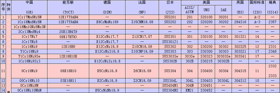

求瑞典钢号2333,相关标准

相关标准SS-EN 10088(SS 142333):
5 y& S' o7 h3 @1 z1 |$ x0 bStainless steel - SS steel 23 33
0 O$ o$ R( M; D# e5 ~( sDescription: SS 142333
' ]- d# ]- Y* }4 k, y- z) wArticle number: 17413 ) ~4 F# ~# o4 {3 J4 T% z0 p
Established: 10/20/1995
4 G6 j1 ~) l" {! F5 C: D: D1 EPublished:  10/20/1995
! ]9 Z" T( f9 c. F( }- mCancelled:  11/15/2002   g2 n+ e- c$ N0 [7 x
Replaced by:  SS 142333      Edition: 13  3 ?3 j. t& Y* |; `9 \' A: M; q
4 o$ S! }( z0 q- fEdition:  12 " N2 u# q1 n5 a7 }9 }2 J, ]' @0 R4 Z9 J
Publication form:  SWEDISH STANDARD
( T2 l* K; P) I) W; bWritten by:  SIS - Materialteknik
2 m" ~& f9 b& [8 x& h+ JICS code:  77.080.20 Steels  . V7 U  a" o9 p% r- p* S/ t
Language:  Svenska # Z( _! j( x8 N9 {  V  w6 N
: h  M0 c( V" O. |& Z3 N* k- x相当于AISI 304
