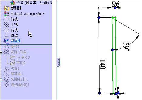

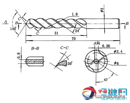

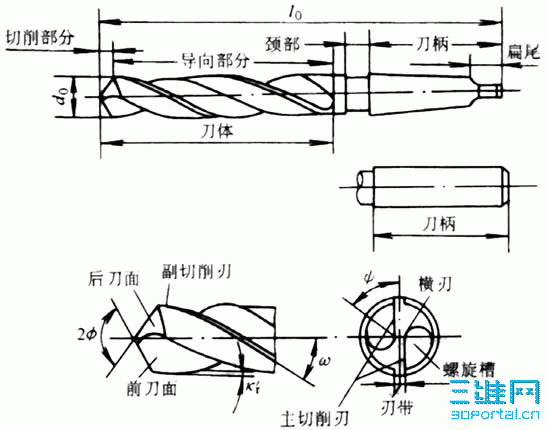

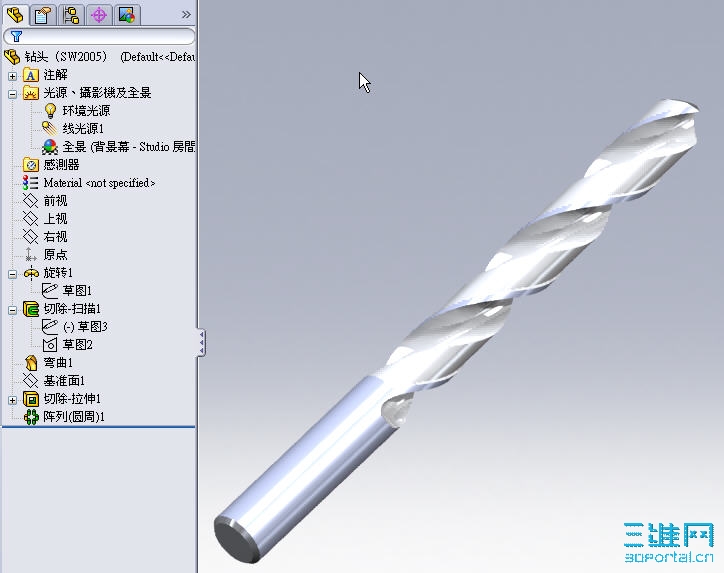

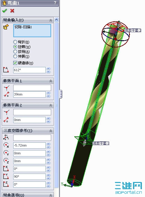

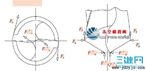

依據麻花鑽的數據畫出鑽头斷面草圖拉伸除料,再彎曲成形.
$ j2 p7 U- @& |% n
5 F: F- e* H; T2 _1 z5 z 1171443647.jpg / y$ {, V0 n! D: K4 ]
  `! M$ y) a! R 1-36a.gif 9 F7 Q9 R# }8 g3 \0 H- k: m
124VK0b430-913Q.jpg 9 ?, s* n  V& B0 _3 P
16123819.gif 9 f/ P+ \% U7 b# q
& ?) `7 ?. C; W. a" Z8 D4 Z
彎曲.jpg   j: @+ d, I4 j+ T& K2 G: H
/ N. ]+ N% w1 O 麻花鑽2.gif
