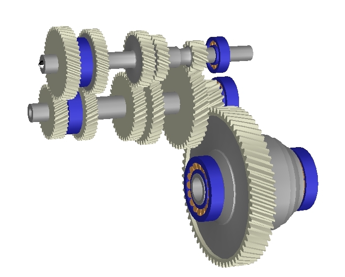

ScreenShot01714.jpg ! X# i9 ~* i. F9 A1 A# y( L0 x
按照romax简明建成建了这么一个模型,但是尺寸检查时出错

Severity2 h/ [* [, ]& |, o6 }
Message
+ c1 ^. o! ?8 L8 w
Action/Description) N  D7 \, ]1 }8 h; E3 X* w' q& O
Failure This integral cylindrical gear is mounted on a non-cylindrical shaft section$ r. @# ~8 f! c1 A# K
Change the shaft definition of shuchu at the mounting location of Wheel 6 to be cylindrical2 x" j9 x. {5 T% ]
Failure Integral gear Wheel 6 geometry is not compatible with the shaft section geometry it is mounted on.
- i3 t& w$ c, s  L5 W- d/ Q- n( q
Check the section geometry of shuchu for sections) v5 S* _% {! u, Y1 a/ ?0 q3 j
- Shaft Section 2
1 Q' ?1 G1 ?$ k- Shaft Section 3
9 j# v3 M, d0 L; ^- Shaft Section 4
. a( E2 Z$ e9 L$ o! W9 V- Shaft Section 59 ?# K3 C* d- n% y% V
The recommended limits are >=159.834 mm, <=172.014 mm) V. y7 y" \% Z  `) P0 ]
The required limits are >=106.556 mm, <=258.021 mm, or make the gear blank a carrier type.

请高手帮忙解答

第一个BUG : 圆柱齿轮被挂载到了非圆柱的轴段上    l( b' w$ c" t
看看你的齿轮是放在什么位置的  是不是放在了 轴段间的圆角面上
2 @( V  K6 U: k( z$ ^' M' ~( r9 n6 f9 d( s5 @4 J( s
第二个BUG: 齿轮6的几何特性与轴不相配
; a( D$ l  J0 w. E2 Q6 |/ n后面的说明里给出了轴段的几何要求  只要把数值修改到这个范围内就可以了
