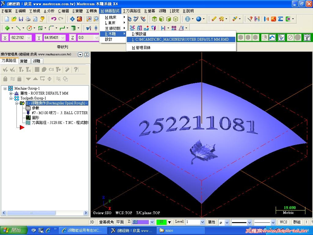

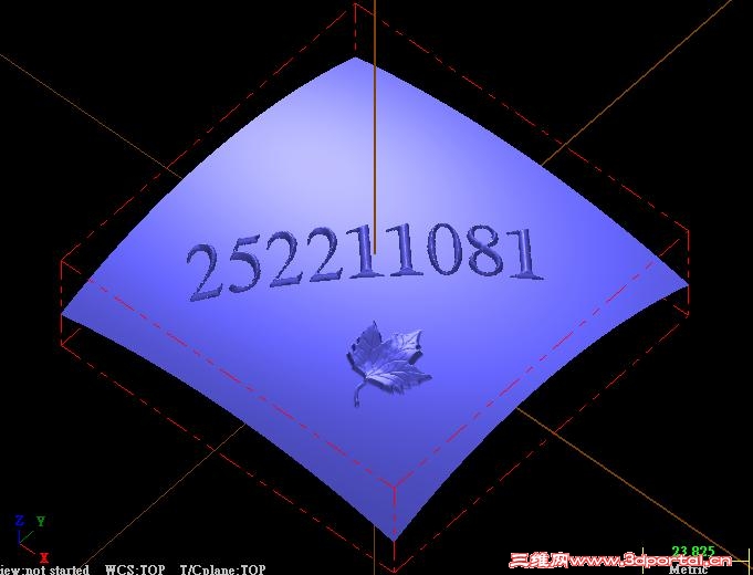

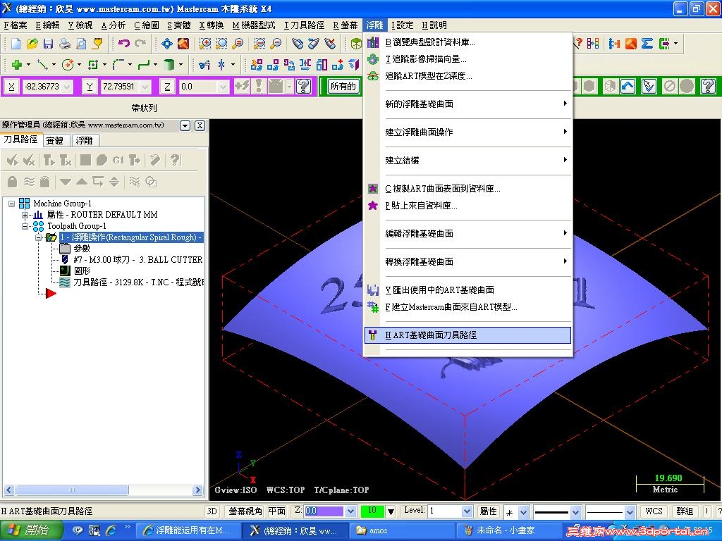

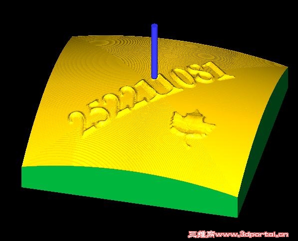

发表于 2010-6-24 02:27:17 | 显示全部楼层 来自: 中国台湾
機械型式→木雕→ROUTER DEFAULT MM
& w, c3 F" {8 o/ \' X8 N' o) @: D7 i8 P  I9 R- n& Q6 k& \  x! ~
$ u7 k6 N' H3 @/ V& p%, @  ^, I+ i+ L/ Q( ]
O0000(T)8 O! g* t  L6 J0 y
(DATE=DD-MM-YY - 24-06-10 TIME=HH:MM - 02:22)! C* J4 U8 H3 A' U9 y+ G! t0 V
(MCX FILE - C:\DOCUMENTS AND SETTINGS\ADMINISTRATOR\桌面\ART-101.MCX)+ T0 E; f# `2 T
(NC FILE - C:\MCAMX\ROUTER\NC\T.NC)
2 M% Q$ h8 Y5 }* [0 }(MATERIAL - WOOD MM)
% `% w5 k: u  S' w; k% R. ]+ h( T7 |  3. BALL CUTTER | H7 )
, P3 U* o" b0 C2 }$ BG17 G21 G90 G40 G80 G64 G49 G0 M05* g9 O0 T# b9 W( s
G8 P1
) O7 ^. I' V& ?2 P, @G90 M05 Z0
! s; I9 W1 Y* M. p$ y; Q5 r. CG52 X0. Y0. Z0.
6 A% n; J2 Z+ oT7 M6
) M6 n6 @3 s" _G0 G90 G54 X-49.9 Y-49.9 C0.  y1 s- k; J4 S& `
S18000 M38 b" R( C; {$ h% {$ V
G43 H7 Z23.428
5 F0 H5 t! P& H$ L2 y( sG1 Z4.683 F2000.1 |' j' D7 ^( T2 ]
Y-48.526 Z5.253 F5000.
6 W. r3 R+ s1 d1 y% N0 UY-47.152 Z5.804! s6 W# P7 m( \/ A
Y-45.653 Z6.385
- w4 g( S9 \: O1 I1 q. G! d" O. p9 `Y-44.279 Z6.897
6 g# S0 k. _& S* `1 Y1 j% rY-42.905 Z7.392
! k8 x) T4 U* v% Q3 ~2 ?: D2 KY-41.531 Z7.87
2 d& s4 M) D/ @( N( pY-40.032 Z8.377 y0 C( R/ z/ W; K" |/ ]  V( K) C- {& I& g
Y-38.658 Z8.813
/ u# i% ~  g* L" F3 s! yY-37.16 Z9.2763 z9 W6 }" O3 g4 ~. b6 m
Y-35.661 Z9.71

发表于 2010-7-7 17:27:44 | 显示全部楼层 来自: 中国台湾
要怎样才能导入原文件啊. N. j$ H. x7 P8 Y% A. F4 W
252211081 发表于 2010-7-7 16:05 http://www.3dportal.cn/discuz/images/common/back.gif
) o% g2 K8 H' y7 S. W就在你的電腦中....安裝目錄下...- ]9 D$ j' t: ^" ?7 m3 h
) F6 C5 \+ q( G9 P2 ?5 o
mcam\documentation\MCAMX_Art_Tutorial.pdf
5 h6 _( w: y# o2 C4 T
0 A  |- f( b. P8 x5 J邊看邊學..
