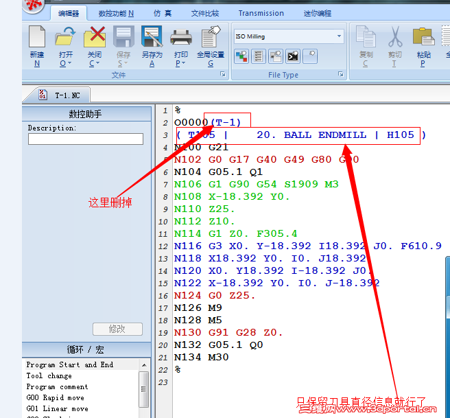

[已解决] Mastercam X6 后处理修怎么改:怎样自动加上GO5.1Q1,下刀点,删除多余的注释等?

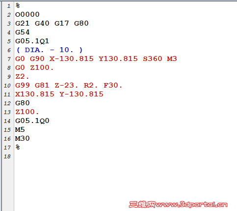

/ Y/ R6 `! b) J- O没啥要求 就是把刀库关了 长度补偿不要 。我用的机器刀库坏了 以前习惯了做模具的 所以也几乎用不到g43  的
发表于 2014-4-23 14:01:33 | 显示全部楼层 来自: 中国江苏盐城
idongjun 发表于 2014-4-23 00:03 static/image/common/back.gif
: V" ^% ^9 K5 t1 O可以,没有问题,有啥要求呢
5 \1 \0 N! e4 u/ D! o6 w$ S/ Q QQ截图20140423140007.png 就这样的简洁就可以了# ]  ^  o  X8 C* q* q

  1.       pbld, n$, *smetric, e$6 T& W: d, S+ C; I
  2.       pbld, n$, "G05.1Q0", e$                   ####加上這列# }  S/ p/ @& n7 }
  3.       pbld, n$, *sgcode, *sgplane, scc0, sg49, sg80, *sgabsinc, e$
    ! N* O& L" c5 [/ y1 `
  4.       sav_absinc = absinc$- a; ~# z1 o) z/ J
  5. % R) _7 B6 A: S
  6.       pbld, n$, *t$, sm06, e$
    7 m& b+ Q( S3 l7 y' {$ G
  7.       pbld, n$, "G05.1Q1", e$                ####加上這列
    $ X; U5 F7 L( N
  8.       if mi1$ > one, absinc$ = zero& ]+ }, \9 w- e* u1 X
  9. 8 z1 b$ S" l7 h2 u# {
  10.       if prog_stop = 1, pbld, n$, *sm01, e$
    ' b0 @; U( i. g- ^. H
  11.       if prog_stop = 2, pbld, n$, *sm00, e$5 c8 U: R- m  L9 n
  12.       pbld, n$, "G05.1Q0", e$            ####加上這列
    " n( Q: @, h2 e* h8 j7 W; C
  13.       pcom_moveb/ w/ `9 l" y6 H+ y2 T
  14. 3 c8 B6 b0 c3 t0 P7 ?; e
  15.        pbld, n$, *t$, sm06, e$
    2 |" n" i3 @0 R$ n% e5 H
  16.       pbld, n$, "G05.1Q1", e$     ####加上這列. b: T% w( ~2 q
  17.       sav_absinc = absinc$
      c% H+ M6 M: i7 Q$ i
  18. 2 f/ ~) p/ n" K  n  Q
  19.       pbld, n$, sccomp, *sm05, psub_end_mny, e$! h- O- n- Y+ A. C
  20.       pbld, n$, sgabsinc, sgcode, *sg28ref, "Z0.", scoolant, e$
    5 c& L/ a3 J- ^, i! I, Q
  21.       pbld, n$, "G05.1Q0", e$                ####加上這列
    ! L. t" e* A, V* j% n7 G6 n
  22. & r! L, u+ g7 L' M/ k$ I- H
  23. 要改註解的...在不想要的那個註解前加個#就不會顯示出來2 p# H/ n- z. k6 `
  24.       *progno$, sopen_prn, sprogname$, sclose_prn, e$# V. E; ?- E3 E
  25.       #sopen_prn, "PROGRAM NAME - ", sprogname$, sclose_prn, e$
    & m8 g6 n8 b, q$ [
  26.       sopen_prn, "DATE=DD-MM-YY - ", date$, " TIME=HH:MM - ", time$, sclose_prn, e$ #Date and time output Ex. 12-02-05 15:52
      w% Z: X9 {0 A6 n% Y; \
  27.       #sopen_prn, "DATE - ", month$, "-", day$, "-", year$, sclose_prn, e$  #Date output as month,day,year - Ex. 02-12-050 c. ~) A# Q9 c8 D7 o. ?
  28.       #sopen_prn, "DATE - ", *smonth, " ", day$, " ", *year2, sclose_prn, e$ #Date output as month,day,year - Ex. Feb. 12 2005
    $ O- f% T8 U, G! {
  29.       #sopen_prn, "TIME - ", time$, sclose_prn, e$  #24 hour time output - Ex. 15:520 y5 w3 y. L  U( [& J' |( B
  30.       #sopen_prn, "TIME - ", ptime sclose_prn, e$  #12 hour time output 3:52 PM% h5 V3 `2 e; |5 U0 |  D
  31. 4 h! Y% O3 R. Z( _- T! g9 [
  32.       sopen_prn, "MCX FILE - ", *smcpath$, *smcname$, *smcext$, sclose_prn, e$# C- o6 W. ~! J' G. E
  33.       sopen_prn, "NC FILE - ", *spathnc$, *snamenc$, *sextnc$, sclose_prn, e$" ]9 t2 w' r! k) ]: O# C$ G' a: ?
  34.       sopen_prn, "MATERIAL - ", *stck_matl$, sclose_prn, e$

发表于 2014-4-30 19:54:49 | 显示全部楼层 来自: 中国台湾
感谢!感谢!再感谢!
发表于 2014-4-30 20:09:58 | 显示全部楼层 来自: 中国江苏盐城
x6 后处理如何把长度补偿  和换刀指令关掉的啊 ?
 楼主| 发表于 2014-5-1 00:11:37 | 显示全部楼层 来自: 中国北京
) g$ q/ U7 Q2 B1 \% r
tianxia839 发表于 2014-4-30 20:09 static/image/common/back.gif) ^  d& [- E5 \$ i% F
5 ~, e" G/ Z4 I! ?1 R% v你用的是哪个版本的呢?如果是X6的话,如下
7 f' S+ L# c4 R; H
' `. d+ c3 r# Q1、不想用G43 H1,
& g  F4 A1 N! x用记事本打开后处理文件,搜索“sg43, *tlngno$,”,删掉这个两个东西即可,应该有两处,仅用1把刀的话改第一处即可!
! n- V* _( l  g' A9 u% k
- m/ ^: t' ]4 \# ]2、不想出现T*  M6换刀指令! F1 ?. J3 c. ^" K9 ]: F0 C3 g8 m
用记事本打开后处理文件,搜索“pbld, n$, *t$, sm06, e$”,在其前面加上“#”号,变为“#pbld, n$, *t$, sm06, e$”即可,应该有两处,仅用1把刀的话改第一处即可!!

发表于 2014-5-4 13:26:23 | 显示全部楼层 来自: 中国江苏盐城
本帖最后由 tianxia839 于 2014-5-4 13:48 编辑 9 a8 y4 h; ~& @
idongjun 发表于 2014-5-1 00:11 static/image/common/back.gif
7 a; I3 G$ Z+ I! z- c  z你用的是哪个版本的呢?如果是X6的话,如下( q# u* A7 C. O# m8 L
# \3 B6 }* f9 ?1 a1、不想用G43 H1,
) c9 [. m$ M0 ~4 k9 g你能帮我修改好么? 我按你的步骤改的还是错误的。后处理出来的还是问题多多的 。我要求的就是添加G05.1Q1   关掉换刀指令M06T1长度G43H1 备刀也不需要 就是没有刀库机床使用的 也不需要长度补偿 QQ截图20140504134521.png 附件里请帮我修改下谢谢; t& D# a: m& u  Y/ i; a
