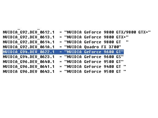

 楼主| 发表于 2008-9-3 20:34:10 | 显示全部楼层 来自: 中国浙江金华
原帖由 makelulu 于 2008-9-3 14:52 发表 http://www.3dportal.cn/discuz/images/common/back.gif
" o; J# W. Z: e5 ]我的是8500GT的显卡要换成哪个ID??还是选择这个老的。。这个ID
7 H1 a" h. c: {6 \  Y
6 u" A9 h0 ]. n7 A$ Z
可试着改为
/ P3 F6 J7 S- s( n% kNVIDIA_G86.DEV_042D.1 = "NVIDIA Quadro FX 360M"

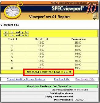

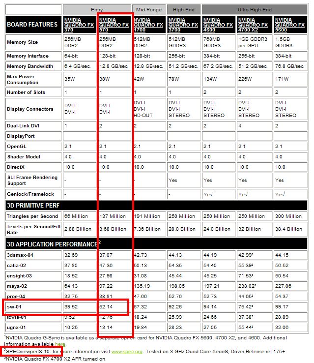

2all
4 M0 ~( K2 i3 w0 CI should like to make some explaination about RivaTuner softmode game cards to professional cards : nVidia GeForce > nVidia Quadro & ATI Radeon > ATI FireGL8 X$ `' X  B+ C' M7 Y
% P; I: M5 {& P; Z
Author of RivaTiner stopped to maintain such a softmode in RivaTuner two years ago. So last GeForce videocads that can be REALLY unlocked to Quadro was GeForce6600 PSI-E (rev. A2) and GeForce6800 AGP (all rev.).2 e5 F; \" y/ A9 F
. E; z# b# A7 U0 r$ }8 _4 `
All GeForce7xxxx and higher CAN NOT BE ACTUALY unlocked to Quadro with RivaTuner. ACTUALY- means that System define them as Quadro (and even let you use RealView Graphics in SW) but the productivity of videocad in 3D-CAD (SW, ProE, CATIA, UNIGRAPHICS.. ets) stay the same as for GeForce (like in GeForce, not like in Quadro)$ ?/ h! c, U! n7 `, R
8 F9 p; x7 L- O+ g  H. @
If you test you videocads in SpecViewPerf (official benchmark for 3D-CAD/CAM/CAE application) you will see it
5 @& T8 l+ G) ]! _$ K& d6 J
1 k" x/ M) C, l6 nlook
* z" K, q5 E, M' ^In "sw-01" SpecViewPerf v10 test for "NVIDIA Quadro FX 570" you have to get  52.14 fps but you have only 20.85 fps
9 u$ Q( ]0 B2 s, [5 d" `) X. a2 K3 E& R
here is official technical data for Quadro...
* D0 W1 O/ n3 A9 }/ `http://www.nvidia.com/object/IO_11761.html3 u, d, O1 a6 I% Z  K% b# B
7 p( c8 I: G  p[ 本帖最后由 solid_user 于 2008-9-4 19:28 编辑 ]
data for original Quadro
data for softmoded GF8600
