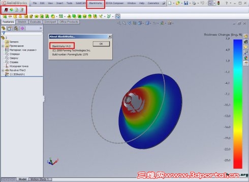

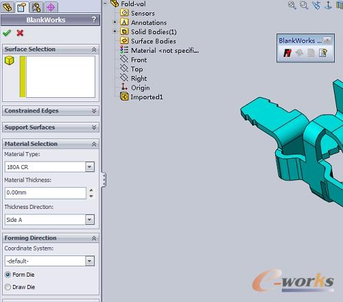

( K2 g4 V6 A6 }: d7 v) I3 分析步骤详解:& z5 y% a: p) `: u
    感觉比起blankworks3.0 ,功能更简单了,不用再手动的处理网格了,程序全自动的处理了,分析的步骤也更简单了,一共6步:
3 }/ P! X$ K2 j" _(1)Click the BLANKWORKS icon  on the BLANKWORKS Toolbar, or select BLANKWORKS > Setup from the main SolidWorks menu.  : T, i$ m/ a; j3 e
    点菜单或者工具栏中的“setup”按钮,启动  设置界面。
* |; @" F9 I$ V2 Q2 _# ?7 p- z) `
http://www.e-works.net.cn/images/128822675405937500.jpg/ g6 N+ |& u1 D  U' h
                   图3
! s6 O1 R" s0 a0 _5 U0 q% {3 A" A8 F7 D8 z
(2)Select all surfaces to be flattened, it can be either the entire model or only the flanges (flange unfold).  These surfaces can either be top, bottom, or mid-surface.
8 }  \( q; x4 H4 J8 K- K    选择要展开区域的曲面(一定要是曲面,可以是上下表面或 者中面。)。
) \: t2 }  V. m4 q& m% P
0 d% W+ N$ e3 H5 o+ w% {( i* ]http://www.e-works.net.cn/images/128822675650937500.jpg; Q$ l' X. v& q# x
                图4. p. @4 L0 X  T5 s

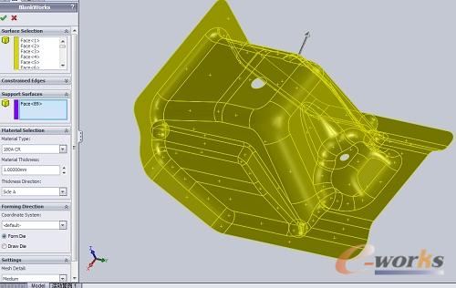

9 Y* f" d1 f) k6 x2 |(3)Define any Constrained Edges and any Support Surfaces (curved binder / unfolding surfaces) as applicable.5 [2 k% q" O7 C
    定义对称边线。和展开基准平面( 没有就算了)。; t, m5 m  `7 J) i
2 S, ?) k* z1 |- B# Lhttp://www.e-works.net.cn/images/128822676843281250.jpg
! D2 X' _9 b. p. O$ W1 I: j               图5
/ S' B; m& j* X2 ]' }& V8 S" N; J2 G1 [/ I$ Q8 _, }2 M

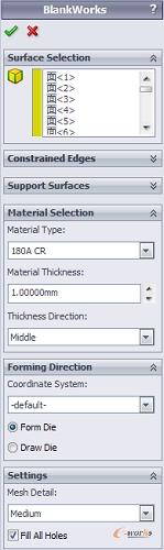

(4)Define the Material Type & Thickness, as well as the Thickness Direction.
# L! C9 R! c6 ?0 k     定义材料、厚度,最好还有厚度的方向( 中间面就免了)。
! e; a! D" w3 E  [* z6 U
$ a2 S: `( \( M% T2 ohttp://www.e-works.net.cn/images/128822677131718750.jpg
2 v3 A/ b: y; r; Z% i# N( w# K3 B0 j$ w- G  T2 \" w
               图6
" T/ l8 O9 d1 o9 w; Y
6 O9 X+ Z+ u5 w, @(5)Define the forming coordinate system (press direction) or select the Auto Tipping function. The Z-axis of the defined coordinate system will be used as the press direction during the analysis. The default tipping direction is the global Z-axis.  If the default axis is NOT used, the blank will be created on the X-Y plane of the defined coordinate system.  Define the forming process as either Draw Die or Form Die.
% n$ R  F7 Q' x9 s* }    定义展开的坐标系(冲压方向)。全局坐标系的Z轴为默认的自动展开的方向,假如此项没有定义,则自动会在 XY基准面上展开。4 }/ @" z1 `; e% |0 C* S5 }6 ~, S
% P7 U6 u3 n- `; n- P  H: Yhttp://www.e-works.net.cn/images/128822677648125000.jpg6 |( v' f2 M9 C' `1 e& g9 P9 J& ?
7 G. F5 O! M/ k7 E& O
               图7
( J: D( j& P" U( ^1 r
+ f% K# S, \- A5 G7 l: P/ @(6)Define the mesh generation parameters by selecting one of the three options available: Low, Medium, or High.  The default setting is Medium. Select the check box for Fill All Holes if you would like the holes to be filled in during meshing and for blank development' Z/ H, z! t/ H% {6 p
    定义网格划分的质量,默认为良好。(还可以指 定自 动补齐所有孔)。
7 S: j' a+ h% E8 }: j/ T4 Z( L) Q, n' |6 y5 o' O

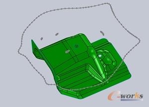

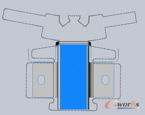

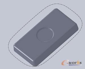

    2008冲压仿真的第二章的例子,测试其1/4展开能力,MID网格计算时间:10秒。质量一般,用高品质再试试,计算报错,不能正常进行。切换成整体的:不   对称。结果还可以。
- v2 D2 v; W) v
3 R3 l$ O+ r' e. ?6 ?4 d& R& P% ?

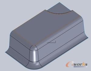

* e; C. X: K/ G6 n* P7 B实例3:
* ^( t6 A+ V% O  m4 `  D) M, o' h. t" f1 F7 S
http://www.e-works.net.cn/images/128822686907187500.jpg
( |- H$ p$ x( J) b; G) e, g! ^( e, x+ u+ L! ?" o) Y) ^" M# G8 |; @
http://www.e-works.net.cn/images/128822687050156250.jpg   http://www.e-works.net.cn/images/128822687159062500.jpg
; @( y' N7 Y# K1 M  S* k- d- G$ b1 C* ~! L& L( b  b4 f
                                                          图11! b& n& `( S" S1 W! z6 T
2 u9 D4 p; Z" w1 C2 J7 C4 C    没有填补孔,孔自动填补:从面上看,质量还可以。
% O" N+ F& d: J/ _* N
, }0 @( H+ f# Y$ l$ t. f, r
- p  U& z; F# J6 W( r/ D' U4 结论:
- I3 w; g$ o) [  M  v    1:零件最好还是用整体的分析,局部对称的有问题。折弯件的展开质量比较高。* {+ d. a' K5 `4 ?9 Y. ]
    2:每次分析完后,要重新分析,信息需要重新输入,不方便。
/ l" j0 t' b0 D1 ]    3:计算的速度比起以前要快一些,而且不需要用户输入网格尺寸了,对于一般用户来说,更方便了。但是对于专业用户来说,就整体说,还是目前SolidWorks平台下最方便的展开工具之一。3 J" f/ x0 X3 V0 `$ ?7 o
