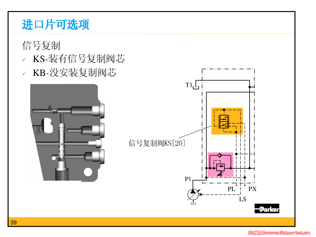

应该是叫LS信号复制阀。The system permits a certain consumption in the load signal line to the pump, without the load signal level being affected. This enables simpler system design, with the possibility of installing logic systems in the LS circuit. 派克的K170LS手册上这么解释的。不过他们这个是内置在Inlet module里了,单独要买这个阀不知道怎么买啊?

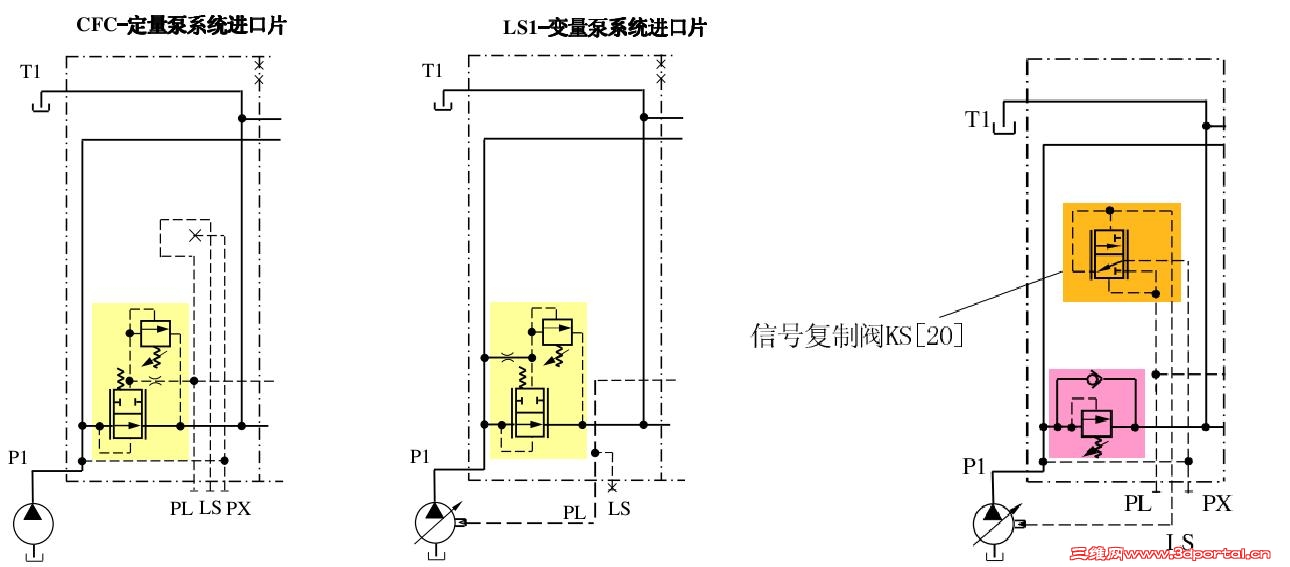

中间图是直接负载敏感回路直接接泵LS口,最右边图是中间串接信号复制阀后再接泵LS口。看来两种都可用,只是最有边这种在特殊场合更好吧。
