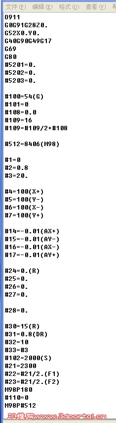

[求助] 请问这条宏程序怎样用???
发表于 2013-10-14 22:20:44 | 显示全部楼层 |阅读模式 来自: 中国广东江门
+ A  c, u, |6 J8 d( q7 j8 _O01200
! H; c) c( {' F7 b, i# k$ JG0G91G28Z0.
& b* w9 @5 s) C2 X: ]! T' q) \G52X0.Y0., i  j# h; L0 E& ~
G40G90G49G17 + L# N, F- S6 N" z( _
G69
2 S! |4 X# |# VG80/ p, p0 [/ ~  i5 q+ U
#5201=0.
# O) u  Y: c0 V+ D# E) ?#5202=0. $ v/ z+ L1 N! W- S/ Y5 a
#5203=0.
4 o$ o3 D# v7 r! R% }
  F+ h# j: y) j; u: Y, ~. v7 x#100=54(G)
+ s( Y' c4 P, P8 U6 V#101=0.
4 o% T) X& |" O) t& r. H2 U#108=0.6 f2 m& I% Y5 b) G& o: P$ s  k
#109=10. # t/ _2 u6 i$ _) {8 W) X
#109=#109/2+#108
$ z8 w4 J* P# E5 G: J% n; {: f, |! U$ F9 E6 O6 R
#512=8401(M98) # F- H% ^  I  ?% z4 Y0 X
7 i9 _2 \2 u8 W5 C' f: P3 M) `
#1=0.- y# V) Y+ x: ^
#2=0.3 & y: }/ O0 ^1 g- I
#3=0.3 ' {$ C! h3 h: a4 B+ `; n' W  J6 Y
$ ~$ z: @- q8 d  b4 \# O5 ^" K
#4=130.(X+)
- E0 J) h8 R. M#5=150.(Y-). W- q  m4 r. J
#6=130.(X-)( p; \* _' _* Q
#7=150.(Y+)/ R" z; R0 J1 x: n" v* h% [4 U; g2 _
# J! W% W6 W. f; E
#14=0.(AX+)
6 {" B; A: B. U# o# c* O' t#15=0.(AY-): {) ~* U: {  t  ~1 S
#16=0.(AX-)
+ V2 ?' a( Q2 W- I  J* ?#17=0.(AY+)
, J) c- D0 Y$ u! l# J- |' S! L6 T0 q* s5 c
#24=0.(R)  X" F6 Q# s$ b; |) d
#25=0.
. Z& i4 W5 j  K5 a" d# i#26=0.
1 S6 K( ?; p/ z6 f( u! _#27=0.
- }  h! @! l/ |0 l  Z# m, W8 X4 H  @$ D; i
#28=0. 3 p+ J# _& B) U% T3 q; f& W; I
  ]; U  G/ Y( T* O: d& u- z! \
#30=14.9(R) 8 k/ N' l! x3 \% U  s4 q# H
#31=0.8(DR)
+ M% c% V( u0 _/ T#32=5. / j1 s: _+ A$ @8 r" d& l
#33=#3
+ w+ T' _% E& W* h#102=2500(S) + G, O5 u) O3 }
#21=3000 $ Q# h: }, _/ v3 h/ H
#22=#21/2.(F1) 8 f6 e1 r# J, X) _- s
#23=#21/2.(F2) / l" R( n' _  J1 U0 r8 r- s
M98P180
* t7 H& ?% N; ~) j#110=0.
2 {! F& V& W3 o+ R7 I2 L8 B# }8 `! tM98P#512   i, b' U4 F  ~7 D# c* O3 w  u. _: `
) I: M0 x7 N: s/ J8 w! K% j1 ]+ b
N99
+ X  r- p$ ~* R0 A. T5 Q3 t. ~  ?M9
# ?# C$ m5 l! u% @9 E. s( k( {G90G0Z120.8 I' ]' j) Y& d5 m) W; `
M5
+ s2 B  f+ H4 \' M' i1 Z- x# KG91G28Z0.
% w+ L! U% j1 k, L( [M30$ @6 G% e( L* Q0 r3 I) B
  H7 ?5 Y( y& T3 Q9 k7 l( j* c, P. X; {/ @3 {4 ^3 x
最好能分解一下。* f+ x" d; e& Z, g  A$ V' [" I0 j
1 `" b% d( x* o( Q8 f% C) q0 z
& K. n  w8 w1 J' f4 K" ]( n) }
) ?+ S( O8 j6 e" W) i' d' S
! R9 j+ a  ~- P
001200.txt
555 Bytes, 下载次数: 5
宏程序

这只是主程序中的变量设定,要知道干什么用,要看程序号是8401和180的子程序的内容。

大概是做框用的宏,#4#5#6#7

把程式补充完整,希望高手们解释一下,这些程式怎样用。听说是出自东莞大厂的程式。% J& u: v5 C* T
- ]: E5 F  s; P% T4 I) \) h6 X
补充一点:精框是用分别:D31R0.8,D21R0.8, D26R0.8这些刀具来精框,所以框可以做负斜度。5 Q% R7 N3 e4 u/ c4 M  l7 C
