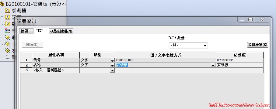

6 t4 Z& {5 a  O( M* ?# z  l比如3d零件名为:B20100101-安装板。
2 Q% h2 a5 `; @5 I. Y  ]工程图里显示为! A' S. u& X( J0 S1 |+ r3 P/ q
代号:B20100101
- q7 y% w/ j) X7 {6 G9 k( D% n; p名称:安装板

发表于 2015-3-5 16:23:11 | 显示全部楼层 来自: 中国台湾
製作屬性
/ F1 p8 z* t, V8 h/ v! w' V 2015-03-05_162241.jpg
# J+ r# H& c) ^7 H

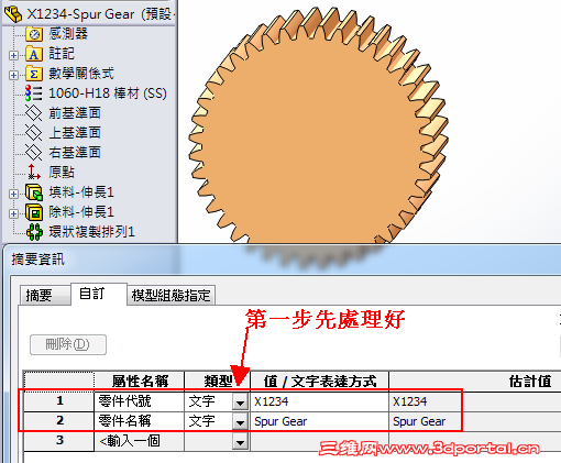

( [- m2 m; \# H% R3 f$ a) _! m5 \( w1. 參考如下,開零件檔先處理零件屬性的代號及名稱
4 B; W! m1 A0 b$ `http://www.3dportal.cn/discuz/fo ... 50784&extra=&page=39 c* i& C! L' i" O

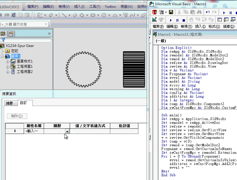

& {% \. |: B* [! w# W2. 開工程圖執行如下宏,可以依據工程圖所對應的零件自動寫入零件屬性的代號及名稱(不開零件檔也行)7 j- n0 n& ?. v  s6 I& R$ O
( T2 Y6 {2 c, ~7 ^1 j1 GDim swApp As SldWorks.SldWorks  K% I* O. }1 r; a3 D
Dim swmodel As SldWorks.ModelDoc2
& i: x  ]& j9 M8 jDim swmod As SldWorks.ModelDoc2
2 B, b2 S- d$ _6 U0 E# }Dim swdraw As SldWorks.DrawingDoc
. U- Q" E$ G* a/ H+ H4 B* e  \Dim swview As SldWorks.View# m/ d. s! g2 s0 V
Dim v As Variant
1 f7 k0 r4 [' x2 v9 ]Dim Propname As Variant
1 }' w' p- m1 \3 f: A  e# YDim evval As Variant
9 p# Z4 R- ?( b$ Y# q2 RDim model As String
& \/ y; _+ `' t8 P( k. KDim error As Long7 m  p( L7 |% W2 J
Dim warning As Long( b7 ]  E8 H4 `4 a, F6 B
Dim config As Variant/ H1 F* a; [3 H  K+ k3 F, P
Dim addstatus As Long
) ^* r* }& s% r* ADim i As Integer9 L# I% e1 l/ v$ h
Dim comp As SldWorks.Component2$ H+ b$ `: N- p0 i
Dim swCustPropMgr As SldWorks.CustomPropertyManager5 l/ W$ E* c0 M% {( S0 g2 E
4 b/ v2 `7 }) `7 B8 |  @Sub main()& R/ n" [& k0 S6 [9 J
Set swApp = Application.SldWorks
. X2 K! |& S$ z! g( ?0 D! PSet swmodel = swApp.ActiveDoc
  v( O9 G8 [+ K6 N( lSet swdraw = swmodel7 C1 h- U: X' [  F
Set swview = swdraw.GetFirstView
0 W, q- q6 D5 z8 |7 W, p/ wSet swview = swview.GetNextView
9 q5 _4 k' z" w6 Cv = swview.GetVisibleComponents* e/ F' d; ]7 ?: W. U+ ?
Set comp = v(0)# Y9 E4 L/ Z0 I& b; d9 C
Set swmod = comp.GetModelDoc2: [* T) x0 R: N- `9 U7 r" u
Propname = swmod.GetCustomInfoNames6 k- Y' o% A3 {
Set swCustPropMgr = swmodel.Extension.CustomPropertyManager("")
3 `$ @$ P' j: \1 p9 |2 D) l$ KFor i = 0 To UBound(Propname)0 S/ u$ x/ p! ^/ x2 R
    evval = swmod.GetCustomInfoValue(config, Propname(i))
& U0 m# _9 G; Q' w    addstatus = swCustPropMgr.Add2(Propname(i), swCustomInfoText, evval)
/ ^7 ]& R1 a% `% c: _9 c0 n    evval = ""5 N7 N; }5 `( {! k) b* `
Next8 m+ H' R2 o  @2 Y( \* i
End Sub

操作參考% R) Q0 i2 W- z7 P8 w
/ c- P* e" o9 M) U- C0 f capture_03072015_160116.png
7 ]0 c) Q8 B# D/ c+ L! ~. [
" G8 Z7 H) f2 W! L% {# z, a  Y7 ?再處理工程圖  ~" N( Z& ~) z/ K+ O& I5 i/ r
