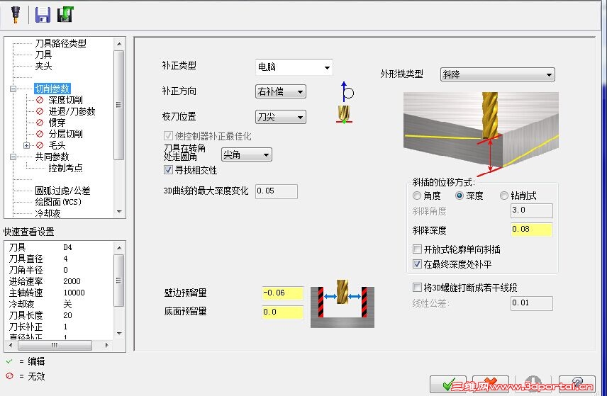

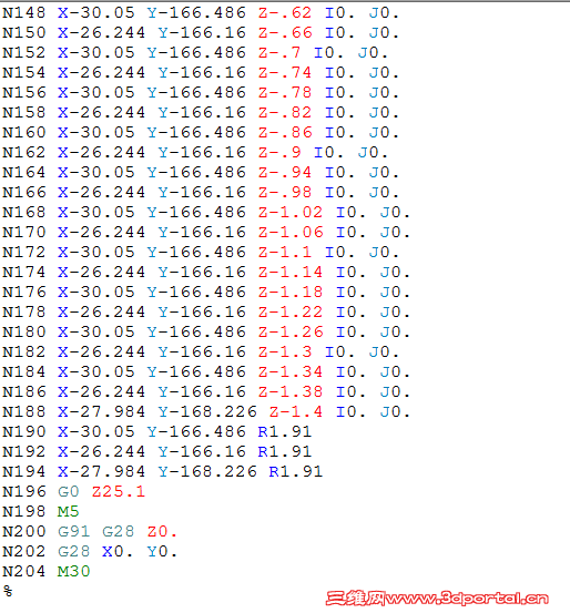

请问各位大神,为什么会出现这么多的I0 J0呢?这个问题该如何解决?' T7 O8 l8 H' o4 X1 i" X

本人用的是Mastercam X5

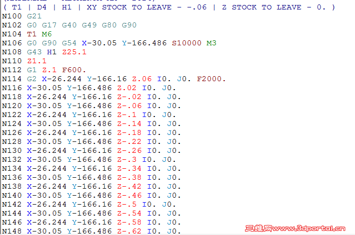

( T/ ]2 Q  Y, z3 l# _' m1 b这是完整的程序!% f9 ~, X" o* S" D, e( I

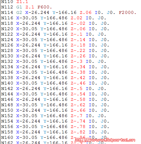

( T1 | D4 | H1 | XY STOCK TO LEAVE - -.06 | Z STOCK TO LEAVE - 0. )9 R) q. t) U: E' k
N100 G21
7 a( t0 ?, R# {: A8 o. s. p4 Y& ]+ uN102 G0 G17 G40 G49 G80 G900 O2 b$ r' }' `; `: E* ^7 a1 s9 c# t
N104 T1 M6, s" B) ^# A/ s/ Q
N106 G0 G90 G54 X-30.05 Y-166.486 S10000 M3
: D3 ]! F8 M' x  G5 BN108 G43 H1 Z25.1
" ~: w5 K  p4 z+ EN110 Z1.1
+ Y, c) s0 o" AN112 G1 Z.1 F600.
" @* V1 u+ r0 K+ {) \, T. f( WN114 G2 X-26.244 Y-166.16 Z.06 I0. J0. F2000.* X0 j) G7 S( l+ P2 K7 I3 Z; k
N116 X-30.05 Y-166.486 Z.02 I0. J0.
. h6 I1 c9 T+ B% W% M  c" EN118 X-26.244 Y-166.16 Z-.02 I0. J0.0 A. w' ~7 Y9 B- _# ^
N120 X-30.05 Y-166.486 Z-.06 I0. J0.  t1 G4 m+ I) I3 ^
N122 X-26.244 Y-166.16 Z-.1 I0. J0.
7 F6 t1 b" K/ y& J& \N124 X-30.05 Y-166.486 Z-.14 I0. J0.3 S3 V/ J7 t, ~2 Y% E! G/ ]
N126 X-26.244 Y-166.16 Z-.18 I0. J0.4 h* |/ G# t; I( N
N128 X-30.05 Y-166.486 Z-.22 I0. J0.( V& x$ o" b1 z# A! V
N130 X-26.244 Y-166.16 Z-.26 I0. J0.
3 b( ?% K; @0 ~: ZN132 X-30.05 Y-166.486 Z-.3 I0. J0.
* O6 a5 [* F5 o& @8 l% \- R: EN134 X-26.244 Y-166.16 Z-.34 I0. J0.  ~7 s- r, K3 x) F
N136 X-30.05 Y-166.486 Z-.38 I0. J0.
& W  M+ E% H/ Y, I0 LN138 X-26.244 Y-166.16 Z-.42 I0. J0.; G" U5 q1 F2 z8 w" Y, t' t/ t0 c
N140 X-30.05 Y-166.486 Z-.46 I0. J0.
9 P4 b) Q+ L( t' tN142 X-26.244 Y-166.16 Z-.5 I0. J0.
( {  v' N$ f4 W- p0 oN144 X-30.05 Y-166.486 Z-.54 I0. J0.
$ D% J8 a% H; U$ U# P/ zN146 X-26.244 Y-166.16 Z-.58 I0. J0.
0 B  T0 x7 C: t, ^/ q6 RN148 X-30.05 Y-166.486 Z-.62 I0. J0.' p- [8 w0 v7 N! o1 x- t7 \
N150 X-26.244 Y-166.16 Z-.66 I0. J0.
( m) @8 S& S+ ^* c: q0 m+ cN152 X-30.05 Y-166.486 Z-.7 I0. J0.
1 t7 g6 ^8 n/ Q4 L4 ^2 GN154 X-26.244 Y-166.16 Z-.74 I0. J0.% f, y: [. x0 r$ h
N156 X-30.05 Y-166.486 Z-.78 I0. J0.4 [# n# ^! p0 w% w2 k8 a- W
N158 X-26.244 Y-166.16 Z-.82 I0. J0.
: j' }8 @/ T. LN160 X-30.05 Y-166.486 Z-.86 I0. J0.5 }' `) K0 K. w; F* k; i
N162 X-26.244 Y-166.16 Z-.9 I0. J0.! U3 U+ T! `: e# \7 o$ r# h
N164 X-30.05 Y-166.486 Z-.94 I0. J0.
: ?' ^1 J. [1 j1 wN166 X-26.244 Y-166.16 Z-.98 I0. J0.! X$ U0 {) }9 ~+ S: ^/ v7 t( c' N" C. V
N168 X-30.05 Y-166.486 Z-1.02 I0. J0.0 K2 e, G" T1 E1 P
N170 X-26.244 Y-166.16 Z-1.06 I0. J0.8 z9 c' ~' L: x% k$ L: V+ ]+ F
N172 X-30.05 Y-166.486 Z-1.1 I0. J0.% q2 J, h$ a; ?3 V: Q
N174 X-26.244 Y-166.16 Z-1.14 I0. J0.
3 q2 G- W( z$ p2 xN176 X-30.05 Y-166.486 Z-1.18 I0. J0.
' e8 O& i) e) @5 sN178 X-26.244 Y-166.16 Z-1.22 I0. J0.* S* H) d$ ~" @2 ?3 G
N180 X-30.05 Y-166.486 Z-1.26 I0. J0.
* u+ P3 t/ Y) G" NN182 X-26.244 Y-166.16 Z-1.3 I0. J0.
! _% \  }% @6 ?1 Q* |& A7 e% v8 wN184 X-30.05 Y-166.486 Z-1.34 I0. J0.& r* J& V" `0 k8 @( M! y% S# V
N186 X-26.244 Y-166.16 Z-1.38 I0. J0.
/ [) ]9 K' Q6 p8 w% lN188 X-27.984 Y-168.226 Z-1.4 I0. J0.
; d1 `4 m" K0 a9 C4 E# [N190 X-30.05 Y-166.486 R1.91% Z& f7 c$ k* s5 r0 H$ \, e! d# s
N192 X-26.244 Y-166.16 R1.91
% n0 _6 ?- b7 `1 xN194 X-27.984 Y-168.226 R1.91
9 J# m' b6 O% A; M+ a3 y% @N196 G0 Z25.1- T9 p% F0 U' I8 G
N198 M5% g4 J7 j$ {) c; ?3 W2 ^4 t9 Q
N200 G91 G28 Z0.
% |3 b1 l# K, k5 P. G: y/ C" U0 mN202 G28 X0. Y0.
- d0 c) r' R3 c3 f, Y, l4 m, b' {' hN204 M30$ E# d7 H- C. n% V0 S0 ~

也许 你需要把G2改为非模态化,也许你的机床系统不能识别吧
0 l' u0 W4 @& s# C3 n你现在可以在圆弧差不的地方手动添加G2试试,主要是你的程序也不复杂,也不多!

机床不能识别I0 J0,加工的时候读取到I0 J0 的时候就停在那里报警了!提示不能识别代码........有什么解决办法吗?如果把3D螺旋打断成若干线段的话就不会出现这个问题!不过加工出来的圆就像是很多直线拼接出来一样!

勾选 将3D螺旋打断成若干线段试试呢?
 楼主| 发表于 2015-5-6 19:30:14 | 显示全部楼层 来自: 中国广东广州
f2705734 发表于 2015-5-6 19:14 static/image/common/back.gif8 y/ b' F$ @2 }% g# A" K# d2 N: s
勾选 将3D螺旋打断成若干线段试试呢?
* k6 J, n- c3 j- {0 o/ M# F" J& Q
这个 可以,勾选之后就不会出现I0J0,不过G02或G03就变成G01了

8 r9 I8 _1 F* d( {% \* {! `% t) i同样这个问题也一直困扰着我,而且勾选后零件弧面总是断断续续的不圆.....只能求教路版了。

  |6 _! h* G0 a0 i, C; T可能是后处理文件出现问题了!我刚刚换了一个后处理文件,I0J0变成了R,估计应该没什么问题了,明天上班去车间试试看
