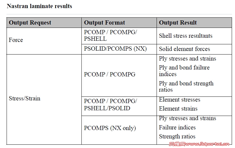

NXLC(NX Laminate Composites)前后处理介绍之Solution and Post-Processing
本节内容首先介绍了使用Nastran作为求解器的特点及部分选项介绍,其二是NX后处理的主要操作及主要显示功能。另外,还例举了两个案例,thick laminated support和卫星天线的结构分析
主要的介绍部分如下:
1Nastran solver properties- Laminate
       What’s the Difference between PCOMP andPCOMPG?
Nastranlaminate export options for PCOMP , PCOMPG and PSHELL cards
2Nastran solver properties
Solid Laminate
Homogeneous Properties for 3DLaminates
3Nastran laminate results
4NXLC Advanced post reporting of laminateresults
       2Dresults from solvers and laminate post reporting
       3Dresults from solvers and laminate post reporting
5Laminate graphical report
Activity:Structural analysis of a thick laminated support
Activity:Structural analysis of a satellite antenna
