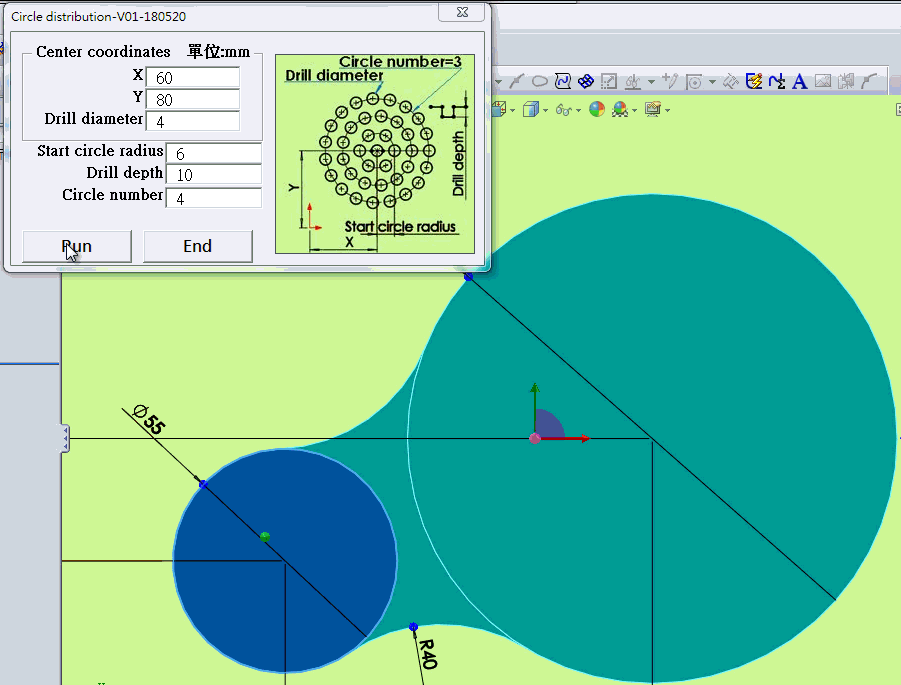

[原创] 圓周分佈鉆孔-宏
发表于 2018-5-20 16:39:07 | 显示全部楼层 |阅读模式 来自: 中国浙江嘉兴
其他
主题分类用于问题归类:
8 g( W6 H$ a* g參考# I/ k# Y9 p) |1 a

  1. Sub Draw_(); x" Z  `/ o! F8 J- p# R: d
  2. With UserForm1: Y; E5 [  [4 i; a9 N6 p- ?  }
  3. '判定資料沒打或是輸入錯誤(起始圓半徑限制不能小於等於鉆孔直徑)# B. h1 g+ A( @# x3 `# J
  4. If .TextBox4.Value <= .TextBox3.Value Or .TextBox1.Value = "" Or .TextBox2.Value = "" Or .TextBox3.Value = "" Or .TextBox4.Value = "" _
    7 |( {* `: f7 I4 s  I" O0 A
  5.       Or .TextBox5.Value = "" Or .TextBox6.Value = "" Then7 g* S/ K  q9 x
  6.       MsgBox ("Data error Or Data empty")
    5 ]% X8 o2 V! e; k7 t9 k# |
  7.       Exit Sub2 r8 r+ M3 t( U# S5 M3 }, h4 R
  8. End If
    0 X1 @! J6 z! X% i1 M/ C" _5 V4 p5 @
  9. Set swApp = Application.SldWorks
    # f$ D& o) J2 B
  10. Set Part = swApp.ActiveDoc
    # u9 b# [# J( H/ {/ g
  11. Set swModel = swApp.ActiveDoc
    + G3 P. z4 d* L- ?6 G3 v' c
  12. Set swSketchMgr = swModel.SketchManager: y0 j) v( ]8 }& e9 ^% A
  13. , g9 p/ p2 p% F/ m
  14. Part.SketchManager.InsertSketch True '依據選取面插入草圖9 p/ ?# J. m- T$ Q0 x, ~7 L
  15. '中心圓之座標及作圖
      ^( f' c/ \  U0 Y. u# L$ X% P; [- X
  16. X1 = .TextBox1.Value / 1000( z9 z4 V$ p: V1 B- k& p4 I
  17. Y1 = .TextBox2.Value / 1000
    4 ~! t9 P* u; p& N
  18. X2 = X1 + .TextBox3.Value / 2 / 1000
    * L# y& `% r8 A, ?
  19. Set swSketchSegment = swSketchMgr.CreateCircle(X1, Y1, 0#, X2, Y1, 0#)
    1 Y, z- X& S5 x8 f" h
  20. '圓周分佈之鉆孔6 K3 f+ y$ ?. m- {& d( Y9 {
  21. pi = Atn(1) * 4& {( l' ?( Z. q- A0 e  K
  22. Drill_Diameter = .TextBox3.Value / 10009 w" l% M4 @$ D' B( p7 V
  23. Start_Circle_radius = .TextBox4.Value / 1000  e& J' D$ l# @
  24. Circle_number = .TextBox6.Value2 [$ i. x( K* C9 F
  25. ArcAngle = pi   '複製孔之圓弧角皆為180度
    * v4 |7 y& a5 f" y3 ]: {
  26. Drill_depth = .TextBox5.Value / 1000 '鉆孔深" E2 n2 T5 W- O$ v* S" ^
  27. For i = 1 To Circle_number  C  x' T$ V9 A
  28.       Circle_radius = i * .TextBox4.Value / 1000 '分佈圓周之半徑2 q5 c" f$ T! n. H2 H/ ]
  29.       Copy_Number = Int(2 * Circle_radius * pi / Start_Circle_radius + 0.5) '分佈圓周之鉆孔數1 q  B- a& L  O! N* P, t3 C, {: A
  30. '分佈圓之基圓作圖
    5 j" h/ h) N6 C8 E. q
  31.       BX1 = X1 + Circle_radius# C1 ?6 M+ h/ G, y3 k5 g
  32.       BX2 = BX1 + Drill_Diameter / 2; |: Z! w5 H  m/ {
  33.       Set swSketchSegment = swSketchMgr.CreateCircle(BX1, Y1, 0#, BX2, Y1, 0#)
    - y& N! B) \3 G. t) w2 V; F5 [
  34. '分佈圓之複製孔數,圓周複製參數:圓弧半徑、圓弧角、花紋數、花紋間距(間隔弧度)、圖案旋轉、刪除實例) X0 a9 b* {( u, m* Q+ E* }
  35.       boolstatus = swSketchMgr.CreateCircularSketchStepAndRepeat(Circle_radius, ArcAngle, Copy_Number, 2 * pi, True, "", True, True, True)
    5 S# M$ G) H  X2 Z7 c
  36. Next
    3 j; ?' c: n! Z
  37. End With' J) Q' {' P/ S
  38. Dim myFeature As Object
    * l7 x# d. u& J5 W9 Z
  39. Set myFeature = Part.FeatureManager.FeatureCut3(True, False, False, 0, 0, Drill_depth, 0, False, False, False, False, 1.74532925199433E-02, _
    2 Q$ T$ P* u/ ~1 r
  40. 1.74532925199433E-02, False, False, False, False, False, True, True, True, True, False, 0, 0, False)
    % G, [! ]/ m, f! j2 I& Q) J1 D
  41. End Sub

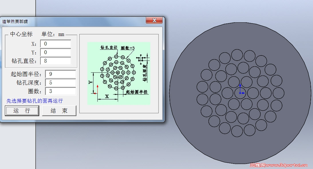

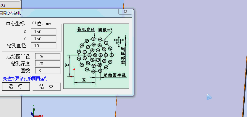

发表于 2018-5-22 09:30:09 | 显示全部楼层 来自: 中国辽宁丹东
ryouss 发表于 2018-5-21 13:19: K2 X1 x' d. K  Y4 X' B8 @
h大應該是沒寫過編程吧!
9 x. \7 U! d% x% t7 r貼上的是主要的計算構思,沒包含UserForm裡的物件,所以無法執行的.
2 L4 p( R; H% m  G: a9 B希望會編程 ...
$ E7 w. _8 ^- E1 A! Y8 A* B) p: f按梁老师要求已转成简体,现供论坛上的朋友测试。
1 ?) e! F( x8 {$ P0 z" L! g1 Y5 C# a 圆周分布钻孔.rar (37.36 KB, 下载次数: 26)

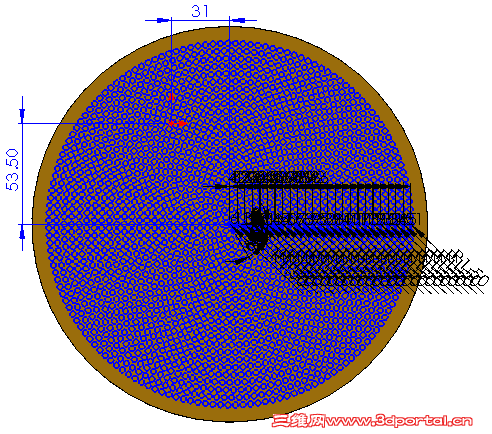

X座標為負時可能出錯,不知有否方案解決?  发表于 2018-5-22 10:41

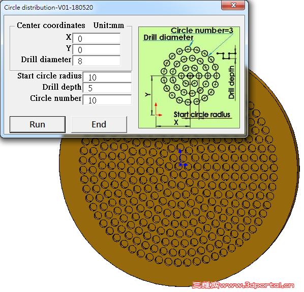

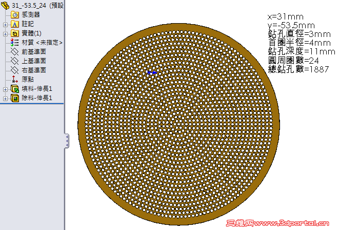

非常感激,2012版試了正常(Userform1之圖像X座標反向了),補充注意事項:
! C/ N2 O4 {3 e! O9 U" `% x
& q; m" ~5 ?' a6 H3 Q7 {8 v/ H$ P0 W' 功能:圓周分佈鉆孔,本範例因是用除料拉伸,所以鉆孔是平底.
* M$ }$ c; o  X" S' 操作: 1.在零件先選取要鉆孔之平面.
/ G/ S$ m. C$ P9 ^9 k! T. Q5 C1 B'          2.執行 "main" .
3 Y5 \5 P' ^1 o0 E/ @'          3.X座標取正數,若是負數可能會出錯.
3 h6 q$ Y& l7 X& t2 I '         4.首圈半徑近似於相鄰兩孔之中心距離.7 f5 z' C: L% ?4 q$ {' E: j/ v

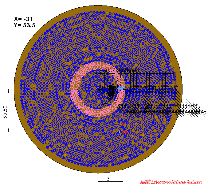

 楼主| 发表于 2018-5-22 11:07:03 | 显示全部楼层 来自: 中国浙江嘉兴
如圖X為-31,以4做偏移時為 4 8 12 16 20 24 28 32 36....0 W) u( ]! O$ L6 d6 o% [
而就是在接近 31 的原點 28 32 這兩圈會出錯,不知有否解決方法?! V* ?" p$ f6 G: }8 h

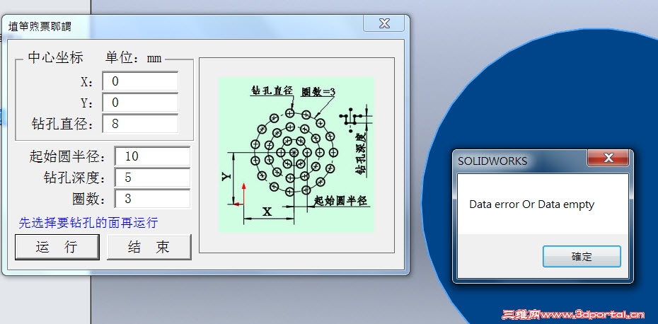

謝謝分享  但為什麼有時候又無法正常執行呢?
 楼主| 发表于 2018-5-23 14:37:03 | 显示全部楼层 来自: 中国浙江嘉兴
+ T2 I- S5 J4 O' A8 G% l% Q
hidingman 发表于 2018-5-23 13:00
3 M9 X0 c, n% y6 b4 Z: T7 y# p0 E謝謝分享  但為什麼有時候又無法正常執行呢?
9 c! {6 y; S& e' Y& J0 wIf .TextBox4.Value <= .TextBox3.Value Or .TextBox1.Value = "" Or .TextBox2.Value = ""Or .TextBox3.Value = "" Or .TextBox4.Value = "" _
$ }! [8 ~3 m) x+ g. k9 y$ t      Or .TextBox5.Value = "" Or .TextBox6.Value = "" Then3 H2 ~% v7 q+ a. n" a; h. W
. r0 E5 [2 m/ K) K, t) q
1. X=0,Y=0 因如上程式把  TextBox1.Value及 TextBox2.Value 的 0 值當成"空資料"了,所以跑出提示"Data error Or Data empty".: |" v& e, w8 {" S. b0 j
2. 可以把如上程式的  .TextBox1.Value = "" Or .TextBox2.Value = ""Or  刪除.; Z% U  ?8 n. s: x' ]+ K6 V1 N
3. 但是測試結果當 X=0,Y=0 時,原點上做鉆孔直徑3的圆又沒畫出,這也是一個瓶頸(試了鉆孔直徑大於等於6.5就可以,莫名其妙??)!
7 _, D3 s& m$ u6 {# c6 y2 q1 k- U8 I$ x
修改測試后之結果煩請回知.! v% z6 ~5 q. Y5 N3 m3 k

 楼主| 发表于 2018-5-24 09:23:47 | 显示全部楼层 来自: 中国浙江嘉兴
6 u7 V4 o- C# R% l
1 V( t( L8 x3 b$ Z- T0 t6 y+ Y謝謝分享  但為什麼有時候又無法正常執行呢?
5 P8 g) a% {- q
昨晚較有時間再測試分析,判定不是0與"空值"的問題,是 TextBox3(鉆孔直徑)及 TextBox4(首圈半徑)的判斷出問題.+ d5 |! q0 x7 |4 ]6 N1 d+ ?+ e
因把 TextBox3 及 TextBox4 的值當作"文本"資料型態了,, ?" f% Z& ~0 X7 z1 ~
數值型態 8 肯定比 10 小,若是"文本"資料型態 "8" 就比 "10" 大了.
7 u9 v' S$ b3 O- a/ b  T/ \所以"判定資料是否沒打入或是輸入有誤"之程式修改為
! j& r* b! t* |6 Y$ e9 x) g/ g( m4 x6 `  y
'判定資料是否沒打入
& `2 I- s: a' N% w! VIf .TextBox1.Value = "" Or .TextBox2.Value = "" Or .TextBox3.Value = "" Or .TextBox4.Value = "" Or .TextBox5.Value = "" Or .TextBox6.Value = "" Then
4 o$ z: S, H. c. E" a      MsgBox ("Enter empty")
" {8 R6 [$ d: d6 V8 {8 ^) z      Exit Sub  l4 S+ ]; h: @7 j. ~
End If
4 |3 d" z/ K) J0 W6 G5 r" V  V'判定資料是否是輸入錯誤(起始圓半徑限制不能小於等於鉆孔直徑)
2 X* U0 }* A9 u' D9 X0 ODrill_Diameter = .TextBox3.Value / 10004 a5 T$ I1 M# v$ d0 n1 O
Start_Circle_radius = .TextBox4.Value / 10000 I4 r5 R% E6 E4 U: `* v( ~( W5 n
If Drill_Diameter >= Start_Circle_radius Then- F- C4 O6 Y  v/ n. y7 @4 u3 \4 I
      MsgBox ("Data error")
7 t, e" ^+ k6 J8 Y5 a$ M      Exit Sub% b, E4 W' d$ E# q9 o
End If
9 y6 H8 R7 |& |" L! t$ J) I( R& O: `2 z! m; ~
8 m" T% x: k- u. ?附上修正檔   Circle distribution_0524.rar (38.33 KB, 下载次数: 12)
