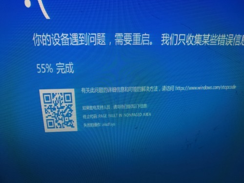

发表于 2020-6-16 15:03:32 来自手机 | 显示全部楼层 |阅读模式 来自: 中国山东
Win10 2004版本 更新安装后,Mastercam X9的虚拟狗失效,打不开。加密狗卸载重新安装时无限重启蓝屏。快崩溃了,怎么办呀?旧版系统备份已经删除,不想重装系统。不知有没有大神知道怎么解决?万分感谢!

 楼主| 发表于 2020-6-17 07:34:17 来自手机 | 显示全部楼层 来自: 中国
安全模式删除安装加密狗的产生的驱动文件系统就正常了。但是没加密狗Mastercam就没法用了。不想初始化重装系统,不知道有没有好的解决办法?

 楼主| 发表于 2020-6-18 22:35:22 来自手机 | 显示全部楼层 来自: 中国山东烟台
Issues updating or starting up devices when aksfridge.sys or aksdf.sys is present An incompatibility issue was found with apps or drivers using certain versions of aksfridge.sys or aksdf.sys and Windows 10, version 2004 (the Windows 10 May 2020 Update). When an affected version of aksfridge.sys or aksdf.sys is present, Windows 10, version 2004 might fail to install or might fail to start after updating. Affected file versions are up to 1.8.0.* for aksfridge.sys or up to 1.51.* for aksdf.sys.  To safeguard your update experience, we have applied a compatibility hold on Windows 10 devices with an affected version of aksfridge.sys from being offered Windows 10, version 2004 or Windows Server, version 2004.  Affected platforms: Client: Windows 10, version 2004 Server: Windows Server, version 2004 Next steps: Microsoft is working on a resolution and will provide an update in an upcoming release.  Note We recommend that you do not attempt to manually update using the Update now button or the Media Creation Tool until this issue has been resolved

 楼主| 发表于 2020-6-18 22:46:35 来自手机 | 显示全部楼层 来自: 中国山东烟台
查了微软官网,他们已经知道这个问题了,说是正在努力解决会在将来的更新修复这个问题,期待一下吧。

发表于 2020-6-29 09:25:26 | 显示全部楼层 来自: 中国台湾
安裝完 win10 2004版後,先安裝 HASPUserSetup檔案,再安裝 mastercam X9,mastercam2021 才不會當機...

 楼主| 发表于 2020-6-29 22:11:58 | 显示全部楼层 来自: 中国山东烟台
a3b3c3 发表于 2020-6-29 09:25' \3 Z: c8 |3 W( ^7 o5 a0 h
, W/ G. @, }! B7 [% z; }# o
6 ~8 M2 s  p! x/ ?8 SHA ...
! f# D6 ^/ D2 w( s, ~  [8 o' @
谢谢大神,亲试完美解决,三维网太有爱了!!!$ J: e1 p8 z8 w( h; L
