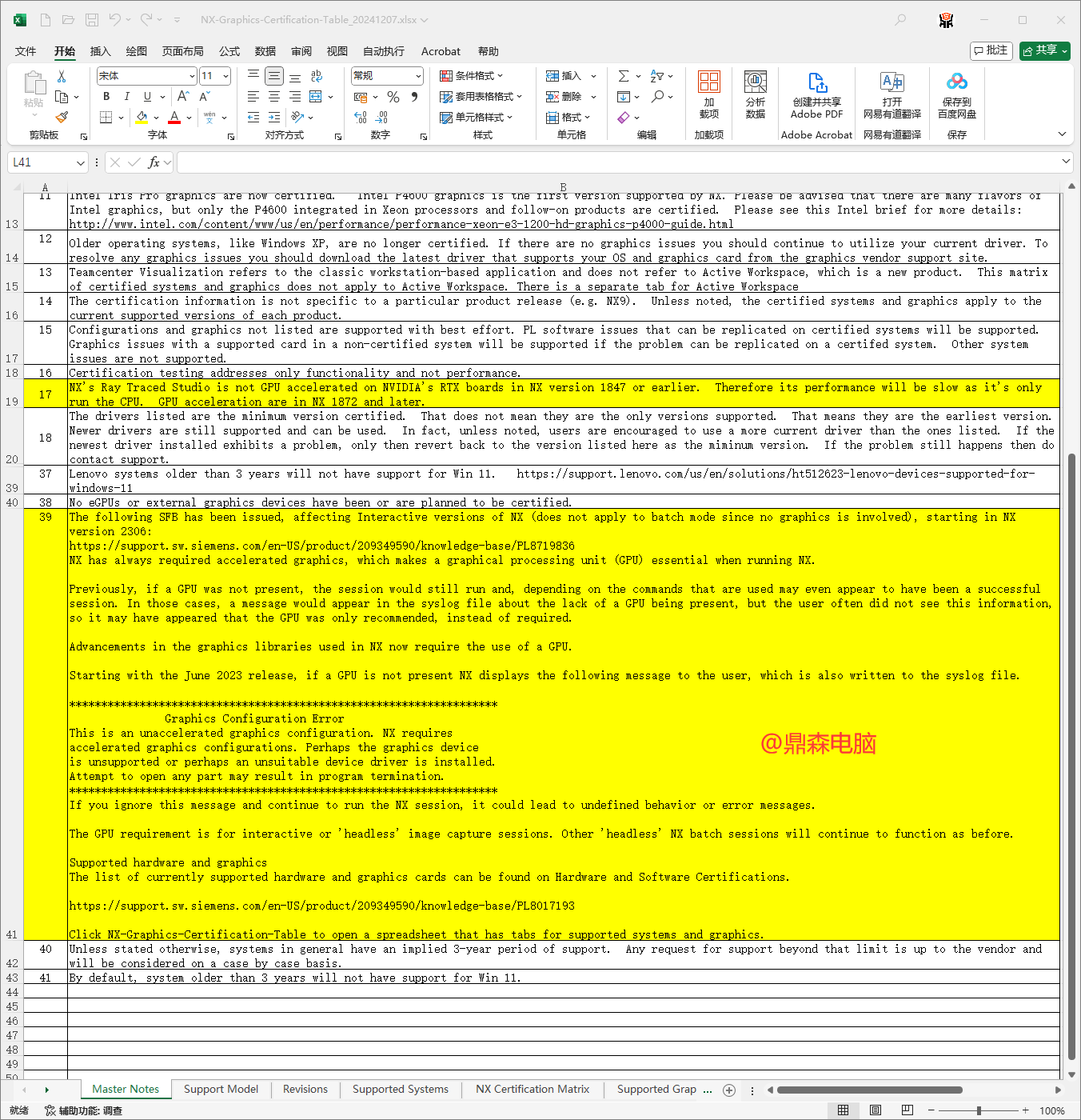

0 t6 w! l4 ?* O; |【1】NX's Ray Traced Studio is not GPU accelerated on NVIDIA's RTX boards in NX version 1847 or earlier.  Therefore its performance will be slow as it's only run the CPU.  GPU acceleration are in NX 1872 and later.
+ v- S* H/ Z4 y& ~$ ?8 F$ o【2】The following SFB has been issued, affecting Interactive versions of NX (does not apply to batch mode since no graphics is involved), starting in NX version 2306:
7 K. H0 Y7 v" f1 Vsupport.sw.siemens.com/en-US/product/209349590/knowledge-base/PL87198368 U2 H$ D7 _; f, A4 R9 g$ U
NX has always required accelerated graphics, which makes a graphical processing unit (GPU) essential when running NX.
9 e% F6 B- y  xPreviously, if a GPU was not present, the session would still run and, depending on the commands that are used may even appear to have been a successful session. In those cases, a message would appear in the syslog file about the lack of a GPU being present, but the user often did not see this information, so it may have appeared that the GPU was only recommended, instead of required.2 ]/ Y$ H" k9 f, ~& F* l
Advancements in the graphics libraries used in NX now require the use of a GPU." X" D  c; A4 s+ Z4 a. g0 o
Starting with the June 2023 release, if a GPU is not present NX displays the following message to the user, which is also written to the syslog file.* ?/ x) O# n0 M7 }9 b  Y
*******************************************************************  H3 e- L! U- m: f7 A: X* \, G7 B9 ?/ X* T
               Graphics Configuration Error
) i& C# H3 P8 `. dThis is an unaccelerated graphics configuration. NX requires! F- [4 v2 w" d! O
accelerated graphics configurations. Perhaps the graphics device
7 J) n) r. _, T* [! E2 G6 p' tis unsupported or perhaps an unsuitable device driver is installed.
' W$ \- b' e8 ^+ c! @& f1 S+ JAttempt to open any part may result in program termination.
# P' b8 U: b# X; e; J; @" X1 H*******************************************************************
: M7 ~' _$ ^7 A; kIf you ignore this message and continue to run the NX session, it could lead to undefined behavior or error messages.
5 Z8 a, U5 M$ q" q; ~The GPU requirement is for interactive or 'headless' image capture sessions. Other 'headless' NX batch sessions will continue to function as before.
1 u1 m& _$ b* L! N* ZSupported hardware and graphics+ _+ j; {( E3 @: d- ^
The list of currently supported hardware and graphics cards can be found on Hardware and Software Certifications.
' K4 [* Q5 G- O9 ~support.sw.siemens.com/en-US/product/209349590/knowledge-base/PL8017193
( N/ u3 F/ x' W) s  F- e3 [5 L3 L: IClick NX-Graphics-Certification-Table to open a spreadsheet that has tabs for supported systems and graphics.- d7 B3 H3 ]( Y; e
# F4 \0 N, v4 z; H* A3 G

! M+ u! ?4 U# {( t! C0 g注意:更多信息请查阅由鼎森电脑整理的文件“NX-Graphics-Certification-Table_20241207.xlsx”。
