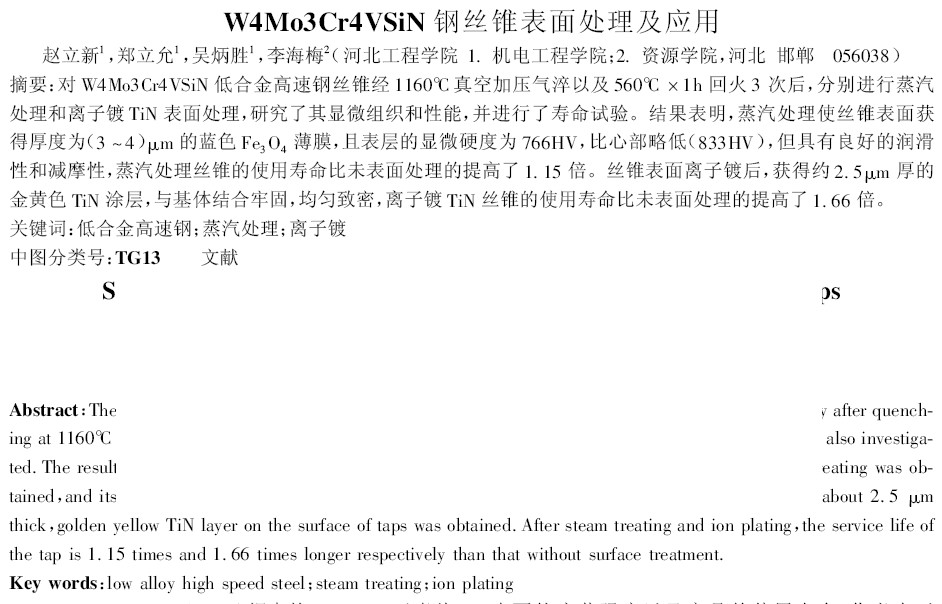

W4Mo3Cr4VSiN 钢丝锥表面处理及应用+ J# ?4 b7 u) E0 Y
赵立新1,郑立允1,吴炳胜1,李海梅2(河北工程学院1. 机电工程学院;2. 资源学院,河北邯郸 056038)
0 ^4 g* |# r& m0 ?& S% ]# J) Y& E摘要:对W4Mo3Cr4VSiN 低合金高速钢丝锥经1160℃真空加压气淬以及560℃ × 1h 回火3 次后,分别进行蒸汽
- G0 ^9 S" L2 X/ Z6 N: l处理和离子镀TiN 表面处理,研究了其显微组织和性能,并进行了寿命试验。结果表明,蒸汽处理使丝锥表面获" ?4 c* M; x# ^
得厚度为(3 ~ 4)μm 的蓝色Fe3O4
9 k4 P; m3 M' E0 m) i: F7 ]薄膜,且表层的显微硬度为766HV,比心部略低(833HV),但具有良好的润滑# ^) n& C9 g0 v3 j
性和减摩性,蒸汽处理丝锥的使用寿命比未表面处理的提高了1. 15 倍。丝锥表面离子镀后,获得约2. 5μm 厚的: k, u' S' Y' @
金黄色TiN 涂层,与基体结合牢固,均匀致密,离子镀TiN 丝锥的使用寿命比未表面处理的提高了1. 66 倍。, V# _' @0 H# t: R: J4 l
关键词:低合金高速钢;蒸汽处理;离子镀: m/ W( f1 j- q" J: C
中图分类号:TG13 文献标识码:A 文章编号:0254-6051(2005)08-0057-03
. S& q& F3 h0 t. ?, J& J+ @/ USurface Treatment and Application of W4Mo3Cr4VSiN Steel Taps' f$ J6 d+ b8 ]0 W
ZHAO Li-xin1,ZHENG Li-yun1,WU Bing-sheng1,LI Hai-mei26 l! A2 d* }5 C& A+ g$ e
(1. College of Mechanical and Electronic Engineering;/ j3 }4 c) L  X0 x9 H
2. College of Resources,Hebei Institute of Engineering,Handan Hebei 056038,China)
% j# v' z, @6 S1 }Abstract:The W4Mo3Cr4VSiN low alloy high speed steel taps were steam treated and ion plated separately after quenching
8 E2 [  g+ D: {4 tat 1160℃ and tempering at 560℃ × 1h for 3 times. Its microstructure,properties and service life were also investigated.4 A3 T6 X+ a9 X0 v
The results show that the blue Fe3O4 layer of 3 ~ 4μm thick on the surface of screw taps by steam treating was obtained,; q; v4 A$ h$ P0 I5 p6 c2 J
and its hardness is 766HV which is lower than that of the inner(833HV). By ion plating,an about 2. 5 μm
+ a* e% i- y3 z0 }/ Zthick,golden yellow TiN layer on the surface of taps was obtained. After steam treating and ion plating,the service life of" c" Q! K3 V, |0 z" [! h
the tap is 1. 15 times and 1. 66 times longer respectively than that without surface treatment.
4 _5 ?9 n% p2 M4 CKey words:low alloy high speed steel;steam treating;ion plating* l# N) e% S6 x# P; Y
