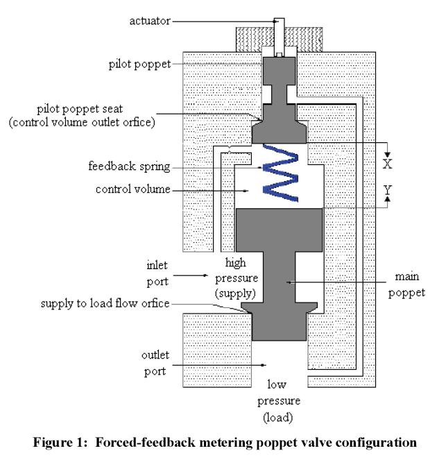

照字面看可以看成流量型提升阀么?, s% C6 `. L/ G' `: j! O7 ]8 o8 b
出去在此,好像是充当伺服阀的角色。$ ?% T6 ?8 h. _5 c2 J
Metering poppet valves are being developed to regulate flow in place of more common. i* o  |, i3 z# U
spool valves. This is due to certain advantages offered by metering poppet valves.
' L- M* R0 M) V7 e+ f  ^" @# I+ i! wHowever, these advantages cannot be fully realized until control design challenges, r5 D$ Q3 B/ b( F+ `% s
involving stability and performance are solved. A design for a two-stage metering poppet
  V2 K, k& {4 j, ^valve is presented. For control, several researchers have used feedback linearization to
$ Y: y. `) m8 v5 V1 \1 vcancel part of a hydraulic system’s nonlinearities in spool valves. In this work,6 P/ x" `; D/ D6 Y/ E& c' p& ]8 ?! [
nonlinearities are cancelled in the input-output relationship of the metering poppet valve.
% c5 y3 l, C8 ~1 r. V. uReference tracking of the flow is analyzed.

我看就一个定压差流量阀

但这个好像不是减压阀,你看他名字叫metering valve,应该是控制流量的吧。虽然我一直没看明白怎么控制流量。就只有一个进油和出油口,怎么控制油缸啊。

楼主可以找力士乐ZDC系列阀看一下,里面有功能介绍。
 楼主| 发表于 2008-1-21 15:26:53 | 显示全部楼层 来自: 芬兰
谢谢pugf68&songwei两位网友的解释。我这就去rexroth catalogue 研究下。
