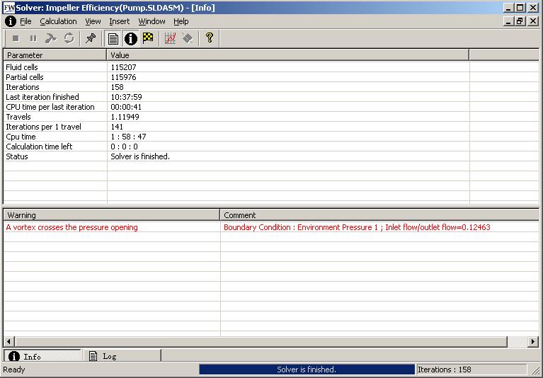

我现在想把进气口压力设为5个大气压,不知应该设为Total Pressure还是Environment Pressure? 0 W5 H' u$ P" S7 S7 l; Y
帮助里的这句看不懂 ) [3 E& D1 D9 W! w* A) H9 R
The Environment Pressure condition is interpreted by COSMOSFloWorks as a total pressure for incoming flows and as a static pressure for outgoing flows. If in the course of calculation a vortex crosses an opening with the Environment pressure condition specified at it, this pressure considered as the total pressure at the part of opening through which the flow enters the model and as the static pressure at the part of opening through which the flow leaves the model.  Additionally, you can specify fluid temperature (and concentration for multiple fluids), turbulence, and boundary layer parameters. These settings are used to define a fluid entering the model at the opening.
9 S& B$ h7 b; u+ @. B谁能解释一下Static Pressure, Total Pressure, Environment Pressure三者区别就更好了
发表于 2009-8-10 22:36:29 | 显示全部楼层 来自: 中国北京
进口压力时最好把对着大气的设置为进口总压101325pa,不要设置为环境压力否则会出现旋流
发表于 2009-8-27 22:02:07 | 显示全部楼层 来自: 中国北京
应该都设置成environment pressure,对于入口被解释成全压,出口被解释成静压。

静压,static pressure 是大量无规则分子碰撞壁面的宏观表现。( Z3 J4 t$ U* `4 P
动压, dynamic pressure  公式是P=1/2*ρ*V*V  是一定程度上反映了气体的动能: Y$ M# r! r& w# K
total pressure ,总压=静压+动压. b) C# V% M! H; j5 N
置于Environment Pressure,floworks解释的很清楚,The Environment Pressure condition is interpreted by COSMOSFloWorks as a total pressure for incoming flows and as a static pressure for outgoing flows.) y$ W8 N. o7 C$ P3 p: e2 h
