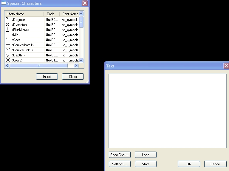

像±,Φ,°,′,″这些常用符号,在ME10中不知道怎么使用的。比如怎么标注96.4 ±1′。本人菜鸟级。/ ~( x2 f9 P8 V" O0 n9 o
两位的方法我都试了,也找不到那个按钮,不知道是不是因为我的是student version的原因,我知道ME10中有symbols和symbols2两个符号库,不知道怎么用?能否截张图啊

发表于 2008-7-28 18:00:30 | 显示全部楼层 来自: 中国香港
通常在你输入文字的窗口有个类似于中文意思为特殊字符的按钮,点开添加即可!

 楼主| 发表于 2008-7-29 14:40:24 | 显示全部楼层 来自: 中国江苏苏州
谢谢了,我用的ME10怎么不一样,点TEXT,还是命令行输入方式的。
也不知道是哪个版本的。不过我也找到方法了。& Z& D3 v( [+ u$ B' F. J
A new text font "hp_symbols" has been introduced that contains some special text symbols like diameter sign, plus/minus sign, degree sign, minute sign and second sign. Characters from this text font have to be preceded by an ASCII 14 (shift out) character and have to be followed by an ASCII 15 (shift in) character when used in a text string. The characters 32 to 96 are reserved for future use and should be not customized. For example, an angle of 30 degrees, 0 minutes, 0 seconds can be written as: ; [8 I; k) G3 J/ o; y( {
8 U5 G6 }; h5 p3 k1 J% t: v7 o: R: P9 x8 E( d1 N7 O
   "30"#14"0"#15 "0"#14"3"#15 "0"#14"4"#15/ _, k5 a3 U# D5 Y' _

ASCII position 48 (value '0') contains the degree sign.
; m( G& E6 N; q$ aASCII position 49 (value '1') contains the diameter sign. 0 i6 k- z; [: ]
ASCII position 50 (value '2') contains the plus/minus sign.
' C* |7 s4 u3 s- g4 n& Z! W) HASCII position 51 (value '3') contains the minute sign.
+ A0 K$ c+ A5 i8 O- s  v  X6 O$ kASCII position 52 (value '4') contains the second sign.
