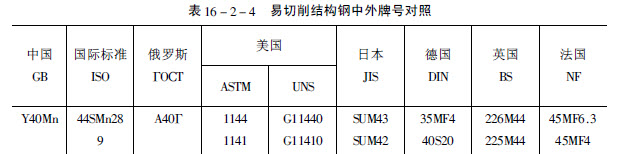

[求助] STRESSPROOF STEEL 1144 是什么材料?

STRESSPROOF® is made by a patented process which consists of drawing the bar through a special die under heavy draft, then stress relieving it. This severe cold working combined with the stress relieving results in a high strength bar with good stability and exceptional machinability. STRESSPROOF® can often replace heat treated alloy steel for machined parts requiring hardness in the range 23-30 HRC. It can be induction hardened but should be watched for quench cracks because of the high sulfur and manganese content. Welding is not recommended. STRESSPROOF® exceeds ASTM A311, Class B.

发表于 2008-10-5 20:57:22 | 显示全部楼层 来自: 中国辽宁沈阳
1144是美国牌号,为含硫易切削碳素钢,其成分为C:0.4-0.48%;Mn:1.35-1.65;P≤0.04%;S:0.24-0.33%5 b1 v1 ^3 {3 u+ V

发表于 2008-10-5 21:09:31 | 显示全部楼层 来自: 中国山东聊城
是易切削钢,硬度HRC36不算低,但必须经调质处理!!!

发表于 2008-10-10 16:03:01 | 显示全部楼层 来自: 中国山东东营
易切削钢,S比较高.3 J+ {9 G5 C7 G) J7 O% _$ @0 G) n
C%           Mn%            P%            S%: K# {6 _! K9 O3 F1 F& j
0.40-0.48        1.35-1.65        0.040max        0.24-0.33
