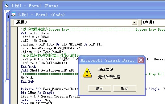

求助各位老大,如何在做好的PM二次中添加"小化到托盘"功能,就象QQ一样

VB实现将程序最小化到托盘区
  M) M8 o  c: e6 F, |4 }& N8 B
- X( }4 l7 S/ a1 A' h, o6 f1 A- ]
! `+ C. ~( a1 s/ J0 m' d0 |3 f3 K- I" F0 H. y. E1 L9 \6 Q" L+ F
1、新建立一个VB6工程,将Form1的ShowInTaskBar属性设置为False 5 g) w4 y+ |: M" c9 q$ C2 X  T0 g
& |' {6 h$ _' ?& r5 q5 e2、菜单:工程--添加模块 按“打开”这样就添加了一个新模块,名为Module1,保存为Module1.bas . M+ |" Y. Y6 x; O% m) y: x
3 z& f/ ~8 C7 }. b8 q
3、在Module1中写下如下代码:
- m, z5 ~5 }3 ^; u
7 y- Z4 k9 |$ I3 \$ ]9 kOption Explicit
) o+ a2 f+ B" O$ m8 K# Z  M" z7 Y1 U' n
Public Const MAX_TOOLTIP As Integer = 64 # z7 E/ u2 b, y) p6 b% C+ s
Public Const NIF_ICON = &H2 , H1 Q" F8 f* E
Public Const NIF_MESSAGE = &H1
( L! r4 D/ O, @Public Const NIF_TIP = &H4   t4 i0 b1 \8 L
Public Const NIM_ADD = &H0
" i$ R$ S6 L, C6 R2 O% dPublic Const NIM_DELETE = &H2
5 P/ t$ P7 m  kPublic Const WM_MOUSEMOVE = &H200
- o! F; [- G% n& D6 j. yPublic Const WM_LBUTTONDOWN = &H201 5 p4 P/ ^; F- Q% R3 \
Public Const WM_LBUTTONUP = &H202
8 B- z1 Y4 d7 KPublic Const WM_LBUTTONDBLCLK = &H203 * p* T0 H  x, l& e4 M
Public Const WM_RBUTTONDOWN = &H204 5 w8 _3 \8 s8 C# P0 _2 }; g
Public Const WM_RBUTTONUP = &H205
' o  R0 K6 U/ H. e  kPublic Const WM_RBUTTONDBLCLK = &H206 9 ~8 B, H* r5 s; S0 G2 I" `# x  R
2 q; ^7 o& }  O0 c: U7 l
Public Const SW_RESTORE = 9 5 p% {# C: W" _* F4 D  r
Public Const SW_HIDE = 0
4 w+ B+ d7 h. c# s  I
! z. O# Z/ d* w8 H( T% k9 y% `Public nfIconData As NOTIFYICONDATA + O  F8 T- b1 T% u6 _4 G& ^
' F5 s% \/ q1 g2 c" h
. [1 w' c# [! e: [( \Public Type NOTIFYICONDATA
. ^; Z; E. H# n. [( C( PcbSize As Long * l4 b& Z1 [0 k! g( K
hWnd As Long
. y$ q# P  H' quID As Long * s8 b/ n, S* o! i) r9 |& V
uFlags As Long
. F6 c& B8 ?# U* K7 R2 K& g* ?uCallbackMessage As Long 0 E- b, g' C9 j+ g% L4 j# f5 t( Z
hIcon As Long
' ?( \6 n( x% ?8 eszTip As String * MAX_TOOLTIP
" Y8 E+ y4 d6 t3 k! t8 k# MEnd Type : R1 M: {: f' Q8 v' m4 u
3 K! u' F* b$ }3 [' k+ G
Public Declare Function ShowWindow Lib "user32" (ByVal hWnd As Long, ByVal nCmdShow As Long) As Long
0 p# o4 u3 p9 _9 _! x6 A* F1 b! O3 L" vPublic Declare Function Shell_NotifyIcon Lib "shell32.dll" Alias "Shell_NotifyIconA" (ByVal dwMessage As Long, lpData As NOTIFYICONDATA) As Long
6 j: l# f  }! m* i6 \
$ m7 ^# C' Y; X3 d# @$ G3 S0 x$ ^$ r'4、在Form1的Load事件中写下如下代码:
, C- n/ x- n4 ~: v5 Y# N1 @5 A/ [* r7 o  |% q8 m% j
Private Sub Form_Load()
9 E. R/ G8 f. A7 b. i( |
$ J; W- H- e! }( Z% e" q- q'以下把程序放入System Tray====================================System Tray Begin - O3 I3 b2 @+ U0 d
With nfIconData
. S* ^! }- @( P.hWnd = Me.hWnd 5 Q8 m% A2 g4 t7 R8 }5 k
.uID = Me.Icon
* ~+ `: h8 F) C) Q4 [.uFlags = NIF_ICON Or NIF_MESSAGE Or NIF_TIP
# d" r( j8 t# `! p. y.uCallbackMessage = WM_MOUSEMOVE % \+ A, h- c" p
.hIcon = Me.Icon.Handle
1 i# I  M: u, g'定义鼠标移动到托盘上时显示的Tip
) n$ V! _, K: e2 o% d.szTip = App.Title + "(版本 " & App.Major & "." & App.Minor & "." & App.Revision & ")" & vbNullChar 8 B! h$ R3 ^" F
.cbSize = Len(nfIconData)
3 g2 |3 J4 w8 lEnd With
7 U% o0 |: f; y1 \& B& ]4 _Call Shell_NotifyIcon(NIM_ADD, nfIconData)
* G3 y6 Q! q: n% O  ^0 _'=============================================================System Tray End 6 N3 Q1 X  P) I+ ?& ]4 [* v# y
Me.Hide 8 [( U6 |2 D. r7 u3 l$ M
End Sub 9 K8 f4 M  E3 Z' X) n8 ^
7 a! p% i* s* @2 z/ n'5、在Form1的QueryUnload事件中写入如下代码: * Z1 p. r3 _4 m$ \' ?' N$ H8 O: J
! I9 d- h- }: s+ `' k- a
Private Sub Form_QueryUnload(Cancel As Integer, UnloadMode As Integer) " X  P, z- U( e# u4 m; y
Call Shell_NotifyIcon(NIM_DELETE, nfIconData) 6 n# h. p- ^. D! e5 s- ?; F
End Sub 6 Z, j4 d" _" d& W
) o4 X% |$ {! @' b+ ^'6、在Form1的MouseMove事件中写下如下代码: ) v, i) N& u+ C2 G
$ Y( b% T- i/ W* i8 uPrivate Sub Form_MouseMove(Button As Integer, Shift As Integer, X As Single, Y As Single)
) \1 ]# r& ^% mDim lMsg As Single " {2 _3 H; x1 @7 T0 ^  a! f/ v6 e) j! n
lMsg = X / Screen.TwipsPerPixelX
5 E; `- x9 M0 U& uSelect Case lMsg
# Z6 q% X& U+ ^5 y; {9 X& hCase WM_LBUTTONUP
4 x( V# d) ?; y- G) _0 z'MsgBox "请用鼠标右键点击图标!", vbInformation, "实时播音专家" - j7 u, J) O, ~' `" d
'单击左键,显示窗体
  p8 X. s( [- w$ p0 YShowWindow Me.hWnd, SW_RESTORE - B* e1 O" T3 q9 Z
'下面两句的目的是把窗口显示在窗口最顶层
& i9 k0 n+ h7 J9 K$ e'Me.Show
: s3 S. p. X% [  o'Me.SetFocus
2 ^) K: m- B& ]/ J7 G  e5 W& ^'' Case WM_RBUTTONUP & q1 p4 v6 L  g6 ^+ y: r
'' PopupMenu MenuTray '如果是在系统Tray图标上点右键,则弹出菜单MenuTray 8 n4 \1 m' g/ H' H! P( O- y1 K4 P; U
'' Case WM_MOUSEMOVE
" s: L) M2 F( y; Y8 x% F! r2 J5 ?( x# k'' Case WM_LBUTTONDOWN ( Q6 T% _# r- B- M
'' Case WM_LBUTTONDBLCLK # Q- H3 q) ?8 j
'' Case WM_RBUTTONDOWN $ Z3 \' p$ i- a8 E
'' Case WM_RBUTTONDBLCLK
8 O% d/ l  {% H2 `2 M& l'' Case Else ( n9 }9 W3 M& v, c2 R
End Select
7 r1 E" T8 `* @" lEnd Sub
2 Z1 ?3 ]" M+ C7 L. \7 m  g3 ]1 E! L# G/ k  x- ]7 w
7、现在将程序保存起来运行看看系统托盘处是否增加了一个本工程的图标。单击此图标,Form1就自动弹出来了。

 楼主| 发表于 2008-11-28 11:37:35 | 显示全部楼层 来自: 中国广东深圳
感谢吉米老大
 楼主| 发表于 2008-11-28 12:07:38 | 显示全部楼层 来自: 中国广东深圳
还得请吉米老大看看...
 楼主| 发表于 2008-11-28 13:08:43 | 显示全部楼层 来自: 中国广东深圳
搞不定...% i0 I- e. k  _; ~
偶刚学VB,我把他传上来,会整的帮我整下吧... 加开机自动运行和小化到脱盘功能....先谢谢师傅们

发表于 2008-11-28 13:27:15 | 显示全部楼层 来自: 中国广东东莞
原帖由 380557319 于 2008-11-28 13:08 发表 http://www.3dportal.cn/discuz/images/common/back.gif
  ?/ e) X' }; W/ Q9 x 搞不定...
  z. C, b& k/ b* Z) k偶刚学VB,我把他传上来,会整的帮我整下吧... 加开机自动运行和小化到脱盘功能....先谢谢师傅们
- T& m4 V. X+ w. q6 l; j2 J5 ?) ]4 A  H0 n
已改好
PM集合_小化到托盘.rar
4.24 KB, 下载次数: 156
 楼主| 发表于 2008-11-28 13:31:11 | 显示全部楼层 来自: 中国广东深圳
原帖由 jimmycnc 于 2008-11-28 13:27 发表 http://www.3dportal.cn/discuz/images/common/back.gif
/ h$ ^' C" N& f2 W* W8 I% [1 n  M  t" ?- [
: M6 j" f9 _# f7 \4 A
已改好
3 y/ `. H0 q! }5 ~  f谢谢吉米老大,可能是代码的格式我还没掌握好      看来还得努力学习

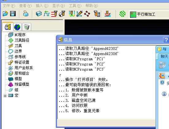

吉米老大, 可不可让它自动隐藏 鼠标一碰又出来  我见你做有个外挂是这样的 赐教
; n5 P$ c7 y& T9 U' d" s4 B& G3 r还有一个问提可能除你没人可帮我了 POWER8.0 有时图档打不开 有解决的办法不 赐教
