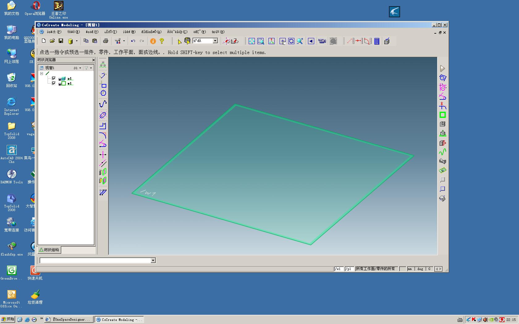

急啊!有高手指点一下吗?

按要求把CHINESE_S复制到E:\Program Files\CoCreate\CoCreate Modeling 2008\personality下,然后在快捷方式中更改成 "E:\Program Files\CoCreate\OSD_Modeling_2008\binNT\SolidDesigner.exe" -e SDLANG=chinese_s
" O8 m" m- g6 D要求是改为"E:\Program Files\CoCreate\OSD_Modeling_2006\SD.exe" -e SDLANG=chinese_s  "E:\Program Files\CoCreate\OSD_Modeling_2006\binNT\SolidDesigner.exe"的,但是我这样改的话,点确定会提示错误,所以我只能改成E:\Program Files\CoCreate\OSD_Modeling_2008\binNT\SolidDesigner.exe" -e SDLANG=chinese_s
