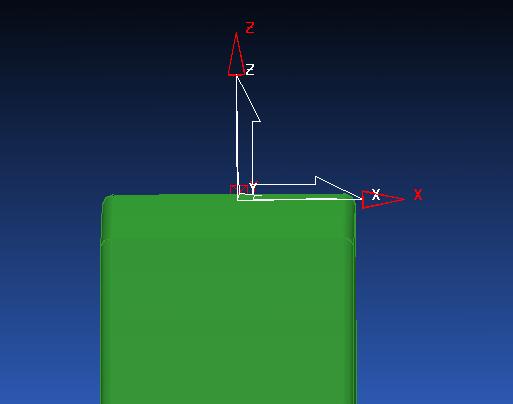

模型输入以后,白色的系统坐标在电极的分中台上。建立用户坐标,用坐标器摆正,系统坐标就和用户坐标在一块了,可是我想让系统坐标在原位置上不动,只动用户坐标该如何编代码呀。。。

发表于 2009-4-15 19:30:20 | 显示全部楼层 来自: 中国浙江杭州
使用创建坐标指令来解决,

pmill.StoreModel
8 D* Q8 F& d5 B. q( a/ m1 O0 Jxmin = pmill.BlockSize(psXMin). O, k1 x# l* n  q! K+ r, s
XMAX = pmill.BlockSize(psXMax)5 C1 Z5 h- c& V7 i# j
YMIN = pmill.BlockSize(psymin)
: W* g* a4 h- d3 GYMAX = pmill.BlockSize(psymax)4 C& w3 a- h1 T- h0 _) a( i
ZMIN = pmill.BlockSize(pszmin)
( _( _5 w7 c- `/ o" [ZMAX = pmill.BlockSize(pszmax)
2 J  Q: ]( `0 L- ]- x( GWKPLX = xmin + (XMAX - xmin) / 2
1 M: `0 ]5 n  nWKPLY = YMIN + (YMAX - YMIN) / 22 S& J0 I; y9 ]. k
WKPLZ = ZMAX
* \2 i% s7 z3 _3 opmill.Execute "CREATE WORKPLANE ;"
- Y, V, A- d5 M7 O7 |4 z* O, ypmill.GetWorkplaneList WorkplaneList, ActiveWorkplane) f* m1 _' G, I
NewWkpl = WorkplaneList(WorkplaneList.Count)
, F/ T; w, C) n4 I! @pmill.Execute "MOVE WORKPLANE  '" & NewWkpl & "' X " & Format(WKPLX) & " Y " & Format(WKPLY) & " Z " & Format(WKPLZ): @* P6 G, u" X; v' H6 A
pml_send ("ACTIVATE Workplane " & "'" & NewWkpl & "'")
& s: i. H' w" K/ Z) e, j5 Mpml_send ("TRANSFORM RESET TRANSFORM TYPE WORLD TRANSFORM MODEL ALL SELECTED")% x. x/ G* ^5 G/ X8 o
pml_send ("DELETE Workplane " & "'" & NewWkpl & "'")% x3 a: p; O6 F0 [
) d7 ^( ^8 ?* O5 n之前给JIM写的一个外挂的代码,这部分是建立坐标的代码,你可以参照下9 b/ O. i  D9 v: }5 ?( B: ~
