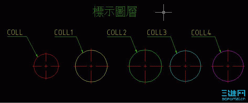

发表于 2009-11-16 21:01:37 | 显示全部楼层 |阅读模式
標示圖層.gif 線上大大们,求助,標示圖層, H9 w! i2 x8 o7 T# ~/ }
如圖把圖層一一標示出來  o" M/ a# R- V/ @/ x6 E
謝謝!!
发表于 2009-12-11 20:30:58 | 显示全部楼层
VBA代码,供参考
  1. / Y8 z2 c' l2 k
  2.     Dim B As AcadBlock, E As AcadEntity, P As Variant, Ps(5) As Double, MT As AcadMText
    " ^: i7 w. c  V" S5 f2 J! W$ c
  3.     With ThisDrawing7 i/ O& k* e$ Y( P3 Z& s
  4.         On Error GoTo 10
    2 Y4 ^% c, Y! D+ a0 ~
  5.         If .ActiveSpace = acModelSpace Then: D9 G$ f8 s+ d2 S. E0 _7 u  ]
  6.             Set B = .ModelSpace
    3 z) P4 s5 W/ A; g) v, F
  7.         Else4 W3 A: j  n+ h  s: r& ?2 z+ @% Y: p
  8.             Set B = .PaperSpace
    ! a7 L0 ]2 V5 [5 e
  9.         End If6 p) a8 y& o% L/ G0 r3 a3 h6 G
  10.         .Utility.GetEntity E, P, vbCrLf & "选择对象:"
    8 v! }- r: m& e: n
  11.         Ps(0) = P(0): Ps(1) = P(1): Ps(2) = P(2)  s' p; }" M# b/ |
  12.         P = .Utility.GetPoint(P, vbCrLf & "指定文字插入点:" )
    4 i9 o( k# U/ q8 u' N6 `3 J
  13.         Set MT = B.AddMText(P, 0, "%<\AcObjProp Object(%<\_ObjId " & E.ObjectID & ">%).Layer>%" ); ~0 v# h1 o) J# }( I* k
  14.         B.AddLeader Ps, MT, acLineWithArrow
    ( H+ s9 |) x. k: B+ I# Y
  15. 10    End With
    - @& n+ v5 y+ `
复制代码
