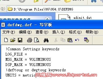

发表于 2010-7-14 02:08:21 | 显示全部楼层 来自: 中国贵州贵阳
在UG的安装目录,默认的是英制D:\Program Files\UG\UG4.0\DXFDWG!) \' F# k# B  m! b& A# Y* w* a
Common Settings keywords: X1 Z# Y- r  q4 d  C: m  Q& J
LOG_FILE =: z7 R& j3 f2 b# b; A
MSG_MASK = VOLUMINOUS
6 D- u' l' u, S% A; Z! T- dDSP_MASK = VOLUMINOUS6 G* Q2 A7 l( g
!dxftoug or dwgtoug keywords
+ A( [* ^+ `4 ~1 ^& h, {8 VUNITS = English( B- T! r& k' c: l
MAX_SPLINE_DEGREE = 3
) c: i! b' z, b+ c- LUGI_DIM_IMPORT_FLAG = ASSORTED_DIMN/ I. {/ A  r# B) T6 O! _, H
!ugtodxf or ugtodwg keywords! X& Q" S4 I) c8 V0 `( K( f& b
UGI_SOLID_EXPORT = 6 K- S/ G  g0 o3 t) c2 D
ACAD_VERSION = R2000
! ]6 ~& g; D* V1 F- M1 o4 P; A4 F- r  R" @& {" u3 |" J
改成公制,直接打开不用导图了UNITS = metric

搞定了!现在就方便不少了!谢谢上楼的详细解答。
